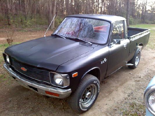

Hello all. I'm new to this forum. I own a 1979 LUV. I am looking for an exhaust kit and or a muffler that works well the 1.8L. Any suggestions?

Good lookin truck.
I'm sure someone that has done recent exhaust work will chime in shortly with some recommendations.

Use the search option.You will find a lot of info.I would recommend two inch exhaust and have your local exhaust shop build you a custom exhaust.I would also say if a local shop has a mandrel tube bender even better.The exhaust that is bent on a mandrel machine flows a lot freer. Spend the extra money and get stainless pipe and muffler then you won't have to replace it for quite a while.
