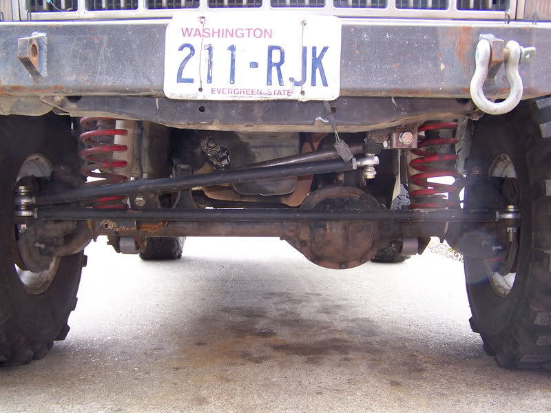

Ive heared more people just using chevy steering boxes. Are you having trouble hooking up steering linkage? Um wy couldnt you do somthing like this? Hope this helps.
(I know this isnt the same but its just aftermarket linkage that you bend and weld to what you need and you get rid of the ball joints. I read that people are very happy with the setup and how they steer. and they are very strong.)

I've thought about doing it that way, but I think my leaf springs will get in the way. I have it set up now like a Ford. Were the steering link goes to the tie rod. I flipped the torrid around and have the steering link hooked to the spot were the steering stabilizer would go. The steering feels really mushy. I think the link " which is z shaped" is flexing. I think i will need to but a flat top knuckle for that passenger side. You said people are useing chevy boxes? What kind are they useing, do you know?
