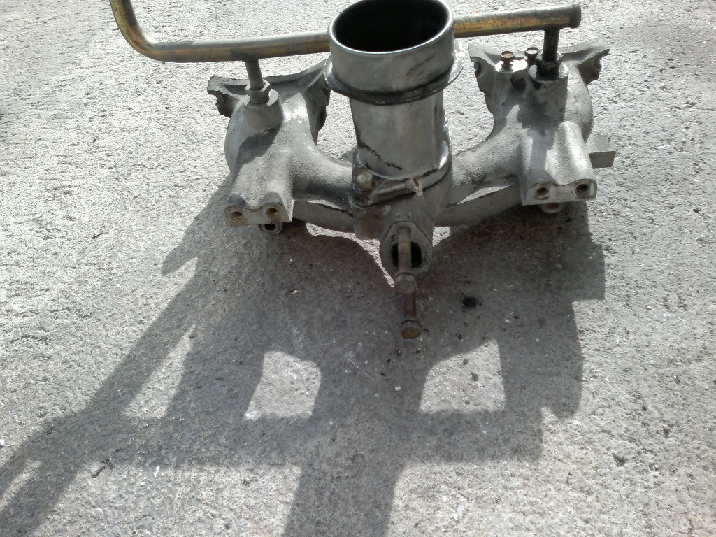

the intake that came on the 84:

Now I understand. This IS a California-spec vehicle. I can understand why the mechanic chose to put the '82 parts on it. If you don't have it, you need the oil separator and you probably need to use the intake from the '84 engine or get one from an '84-'86 Federal-spec engine.
