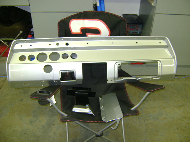

after
the lighting dose it no justice , but trust me it looks great . now i have the fun part ahead , putting it all back together .ye haw .

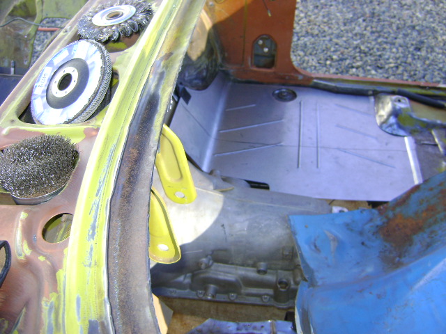

Its looking really good :) . How hard was it to get the stock luv metal dash out? How involved was it?
 Post subject: Re: Norms 75 luv build
PostPosted: Sun Mar 27, 2011 12:33 pm
Posts: 158
Location: cental point oregon
I cut the top about a inch from the windshield
and on the sides you just drill out the spotwelds and your out .
it takes about 20 minuts ounce you get all the other stuff off the dash .
