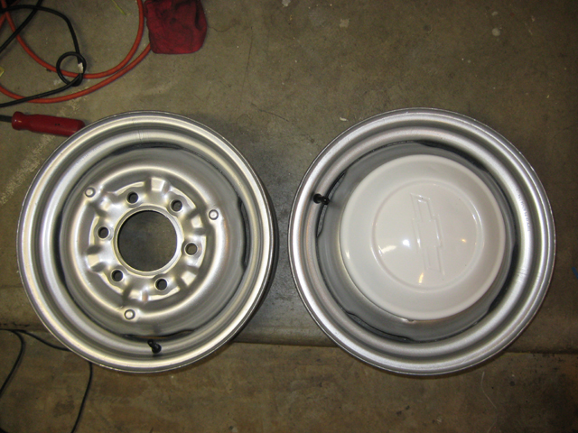

So, I got around to doing some rim painting. Decided to unmount the tires since they were spares, my truck came with two snow tires. Anyway, I used VHT Chevy Rally Silver that I got from Summit. Before painting, I sanded the rim with a fine grit sanding sponge that I got from Harbor Freight. Sanded, blew the dust off, wiped with denatured alcohol, then put on 2 coats on the back and 3 on the front according to the directions on the can. I found that 1 can is not quite enough for 2 rims. I believe I will end up buying a total of 3 cans for the 4 wheels I will be painting. I also painted the hub caps, I used Duplicolor Olympic White. They were prepped in the same way as the wheels. In either case I didn't really sand any paint off, just the gloss so the new paint would stick. I feel it came out pretty well, and the silver paint does a good job of hiding the scratches I made from manually unmounting my tires. I've included a 'before' pic that shows the average condition of the wheels.

Looking good. It is now time to paint the chevy Bow-Tie
 Post subject: Re: Painting your rims
PostPosted: Sun Feb 22, 2009 7:32 pm
They turned out good.

are those the stock wheels? the only stock wheel left on my truck was the spare from 75 but i have been trying to find wheels just like that.
PostPosted: Tue Apr 07, 2009 8:55 pm
Posts: 497
Location: Upland, CA
As far as I know they're the stock ones. Some day soon I'll get around to painting the other two. Oh and it was so nice, I went to Just Tires to have the tires mounted on them and they did it for $15 a tire and gave me free balancing. Now I have the receipt for that so I should be able to get them to do it again for me. Probably helped that the wheels weren't on the truck.

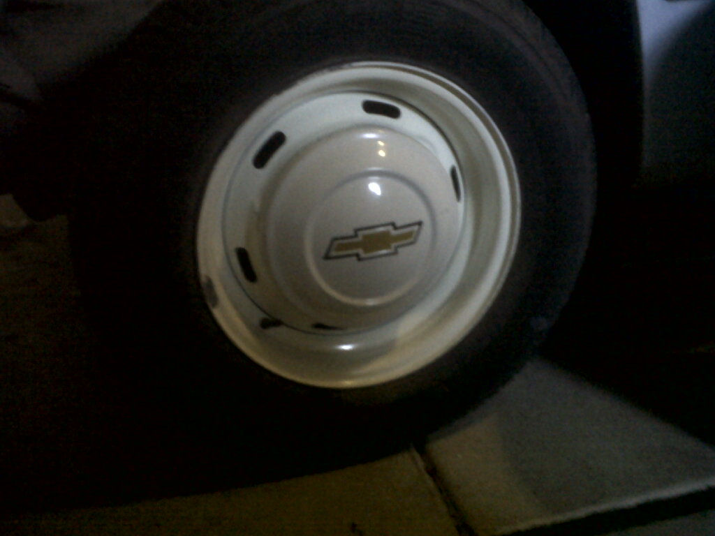

Finally finished this project
PostPosted: Fri Jun 18, 2010 8:36 am
Posts: 1387
Location: Great Falls, MT
Looks real nice. Did you use the aircraft paint stripper? Did you get it from Wal Mart?

PostPosted: Fri Jun 18, 2010 5:19 pm
Posts: 151
Location: Reno NV
I used a few brush on the rust spots. Then used sandpaper and steel wool the do the rest of the prep before painting. I used Duplicolor paints.
