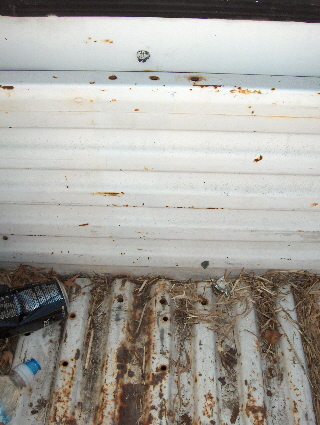

i need a pic of the spare tire carrier for the 4x4 mount.

yeah sorry, thats what i meant. i want to see just how the tire is actually secured in the bed. i have it underneath the truck bed right now, but i want to move it for the times i go off roading.

I'm going to use it, but I can post a pic of it.

The tire would not fit with the roll bar in, so (not me) hammered this mount flat and put it in the floor of the bed. In the other pics you can see where and how it should be mounted.

so it DID at one point have the tire mounted in the middle of the bed right?
PostPosted: Thu Apr 01, 2010 4:58 pm
This truck did. That mount was originally mounted left of center, up against the front of the bed. Top holes in the top of the rub rail, and bottom bolts in the floor of the bed. The bracket flanges were bent in opposite directions. Am I making sense?

yeah i get it. kind of like a semi-straightened Z right? top sits on the lip of the bed, bottom on the bed ridges.
got it. gonna have to make a custom one that will also hold the jack and lug wrench altogether.
