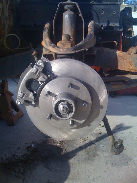

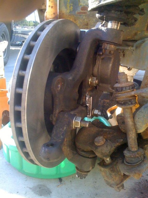

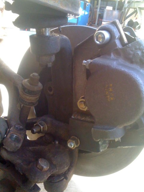

Pictures of the kit prototype
I apologize now for the rough look. it hasnt been cleaned up or painted yet, i just wanted ppl to get an idea of what its going to look like.
We will have some better pictures up as soon as the frame gets media blasted and painted and the kit gets the finishing touches.

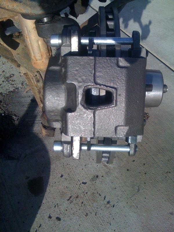

last pic
Comments or questions appreciated.

Not wanting to rain on anybodys parade, however with todays machining equipment, why not just make new hubs that utilize the stock rotors, with either Chevy or Ford bolt pattern. Built a few back in the late 80's, cost was outrages as each one was made singly on a lathe. Drawings from then are long gone.
Comment on brackets; it appears that the caliper rotation forces are being applied to the slider pin. The brackets can be lazer cut, however the point where the caliper slides should be machined for accuracy to take the rotational forces.
why not just make new hubs that utilize stock rotors?. a couple reasons... 1) Nobody knows how long stock LUV rotors (and calipers) will be around for. 2) stock LUV rotors don't exactly provide what I would call great stopping power. 3) Sure machining technology has improved over the years but why do any machining at all if its not necessary. Why re-create the wheel when its already sitting on the shelf ready to use with some minor modification. Every added machining process adds just that, an additional process, not to mention additional cost.
Rotation force is being applied to the same spots as it would be if it were on an S10 truck. In fact the backing plates on an S10 are pretty flimsy compared to the 3/8" steel these plates are made of. Just the same, the plates are machined very precisely.
