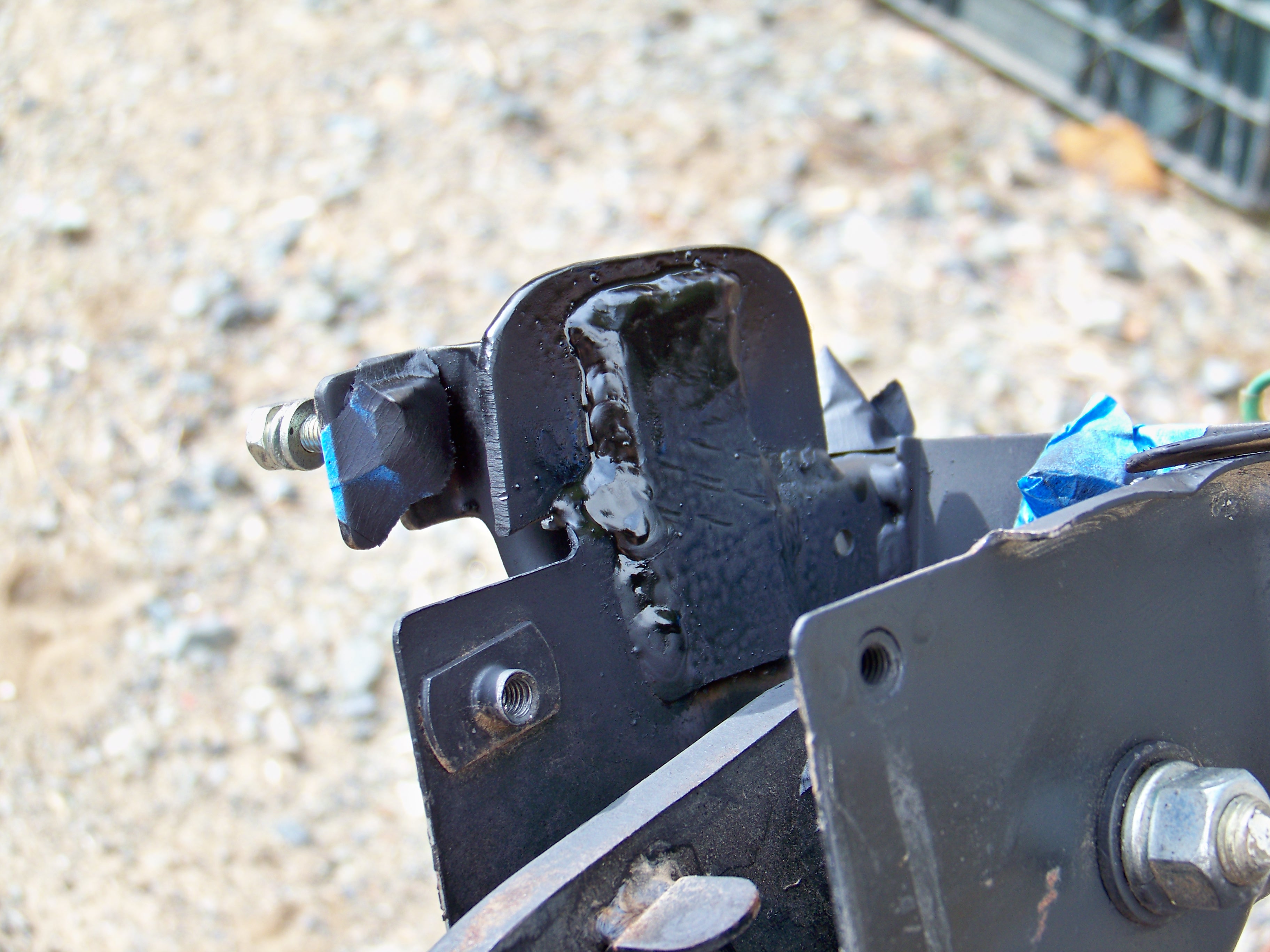

Here's the finished repair. I added a plate three times thicker than the original sheet metal. Clutch is solid as a rock now. I only got 19 photos on this thread. Hope most of you out there enjoy them.

That is some truly astounding looking welding. I was able to notice this by the sharp, in focus pictures. That camera is amazing! How much did it cost the state...

Thats not a weld, I seagull flew over it and dropped a his lunch and it was painted.

Being as fullaluv's reinforcement looks a bit excessive, here's how I fixed mine, same problem:

I don't have a problem with him, but a few things he has written have offended a few others (and frankly, I don't think he's going to get any help anytime soon). He doesn't take advice very well, but that's all fine and good, because he documents what he does rather well (he can find his mistakes later). And sometimes people just don't understand his sense of humour (I definitely don't).
I might be kicking myself for bringing this thread back if we don't keep the discussion to an automotive level. So, let's keep this devoted to clutch pedal brackets and their repair/replacement.
