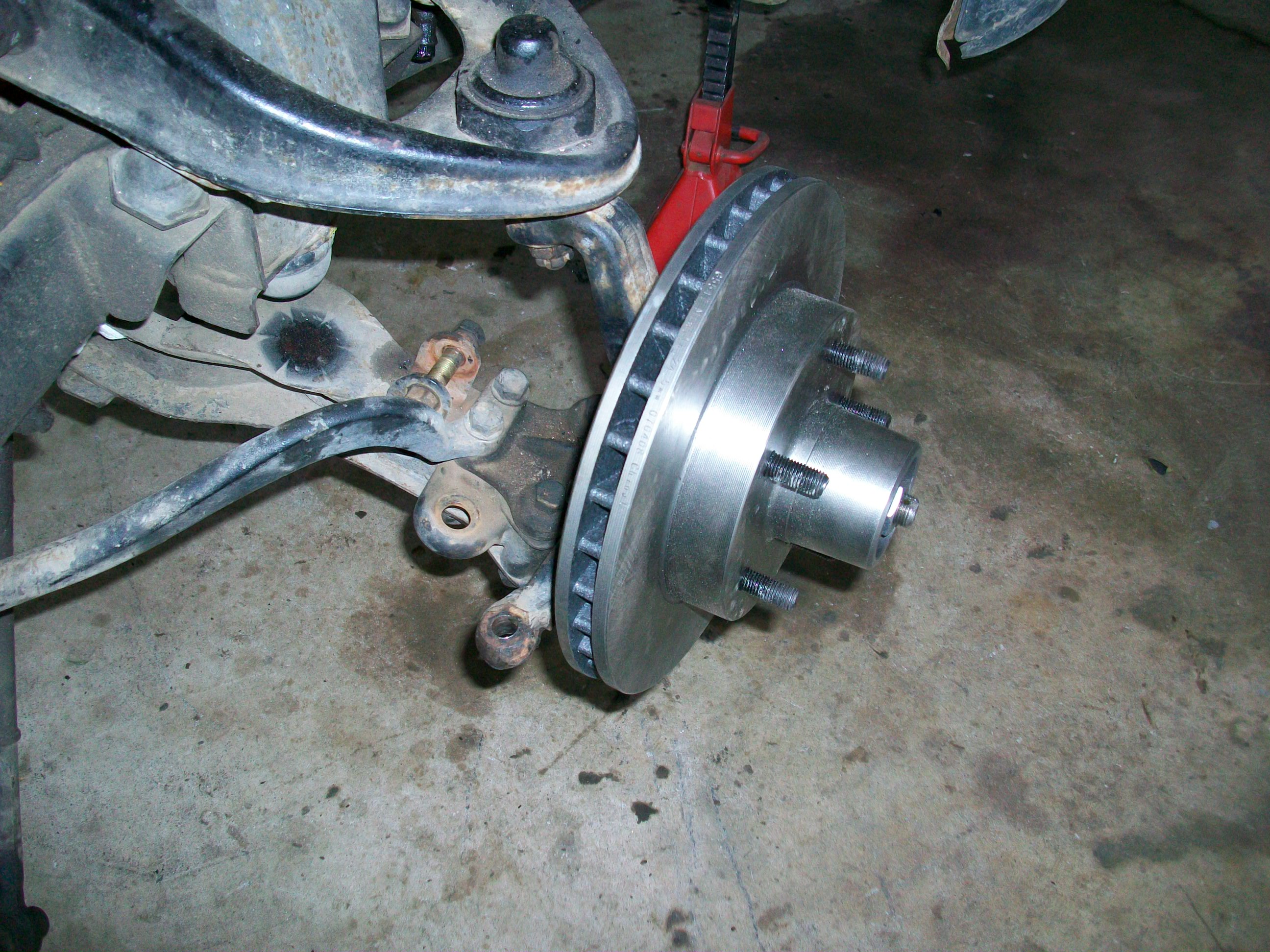

PostPosted: Mon Aug 03, 2009 10:57 am
Joined: Fri Jul 24, 2009 12:41 pm
Posts: 19
got the rotor stuff figured out . . . spent saturday morning at the parts store then a few hours at my buddies machine shop . . . got the rotors on and gettin close on the caliper mounting though i forgot to snag a pic of it . . . so far its s-10 rotors, chevy luv inner bearing and race . . . the outer bearing is same id as the luv but 47mm od instead of the luv 52mm od . . 78 malibu rotors and the caliper brackets started as the speedway motors ones for the caliper end and i will finish with cardboard templete for the spindle side and i will be having my buddy cut them on his plasma table so there could be more made . . . the finished width of the wheel mounting surface ends up the same as the stock drum brake mounting (mine had drums thats the only thing i could measure)
