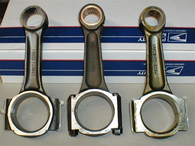

now then theres the rods.......
theres only about 800 sets of gen 3 rods in the USA, and most are in troopers.
theres also GEN2s but i dont know how many sets of those are out there.
i figure this will help you and others doing diesel swaps and or repare.
and yes the part numbers are the same on GEN 2 and 3 i have no idea why.
