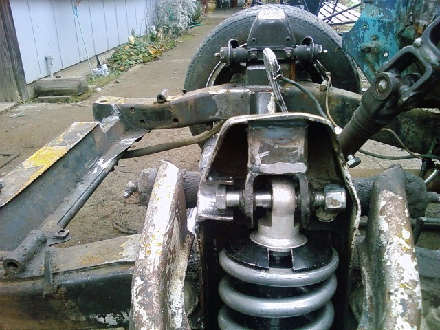

My shocks are 3955 QA1 9 1/2 compressed and 12 5/8 extended, should I go with heavier spring, My truck is a back halfed drag truck only.

well I got my connection from phone to pc for pictures usb memory stick that reads phone memory cards. anyway I am not the happiest with what I have done I want to clean it up and cut out the inside part of where the bolt slips through it doesn't look good and blocks a bolt to the control arm for shimming. but anyways I got em on bye bye torsions
these are the 550lb springs needless to say the control arms are not resting on the rubber stops like the torsions did without engine in.
