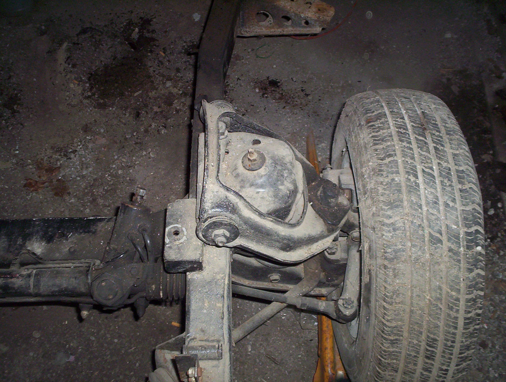

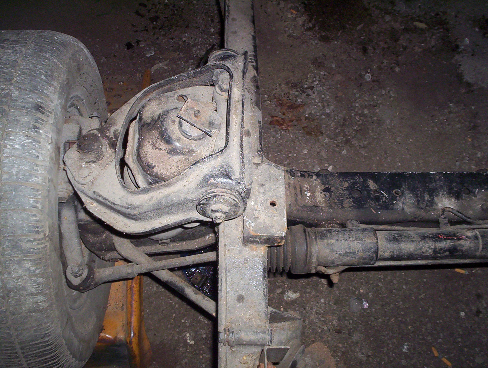

WHAT I DID ON MY LUV WAS I BOUGHT A I THINK IT WAS A 76 77 78 MUSTANG II and cut the front end out of it. it fit real nice just a small amount of cutting and it went right in o and the track bars that go back wards on the car i run them to the front and fit to the frame real nice and lots of after market parts and cheep to

here i did some picks i just notched the frame i just uesd the cross member the mustang II has a rectangel subframe i cut it and then notched the luv frame

more
