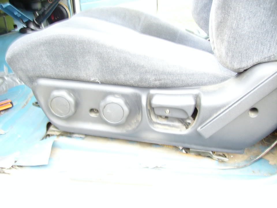

I've decided to write a tut. on putting in bucket seats into your 81-82 LUV Pup wutever your doing. This tut. is using a 82 Luv and early 90's corrolla bucket seats.
Step 1:

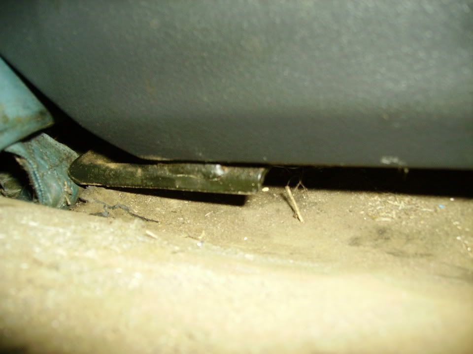

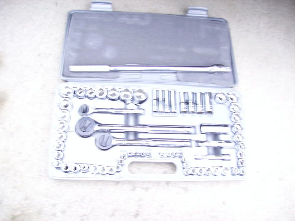

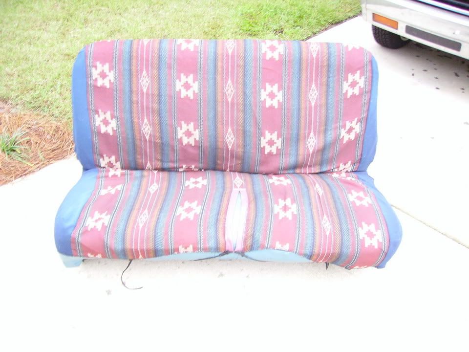

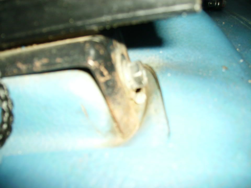

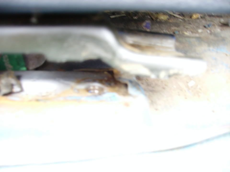

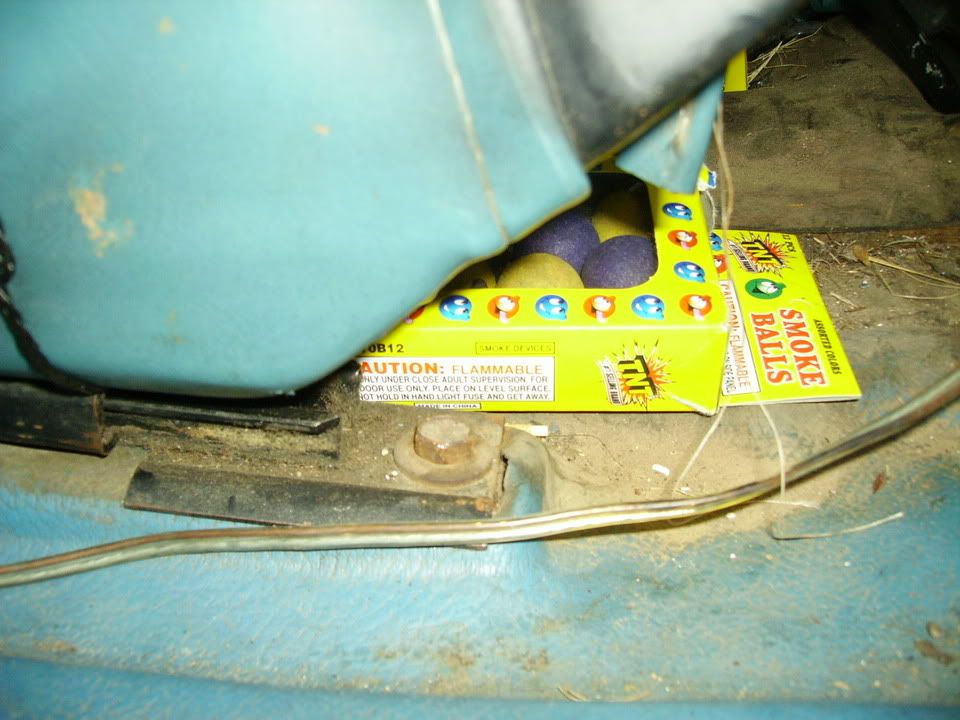

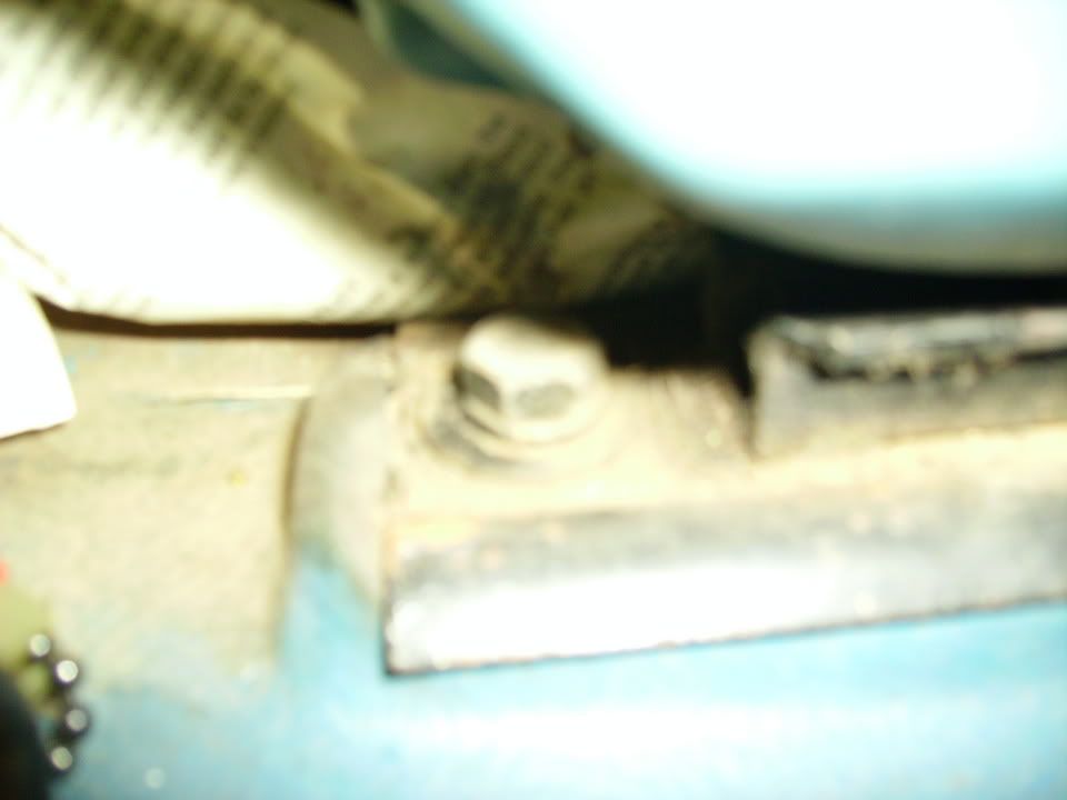

Locate bolts that hold seat in, remove bolts and extract seat(s)
(don't ask about the smoke bombs... lol)

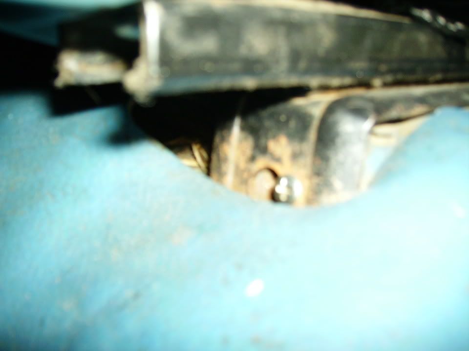

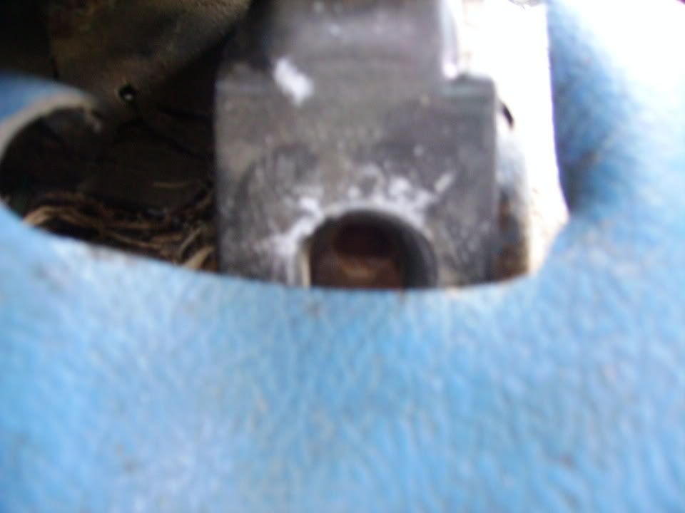

I also had to remove a broken bolt in the front driver's side, very easy to remove.
Step 2:

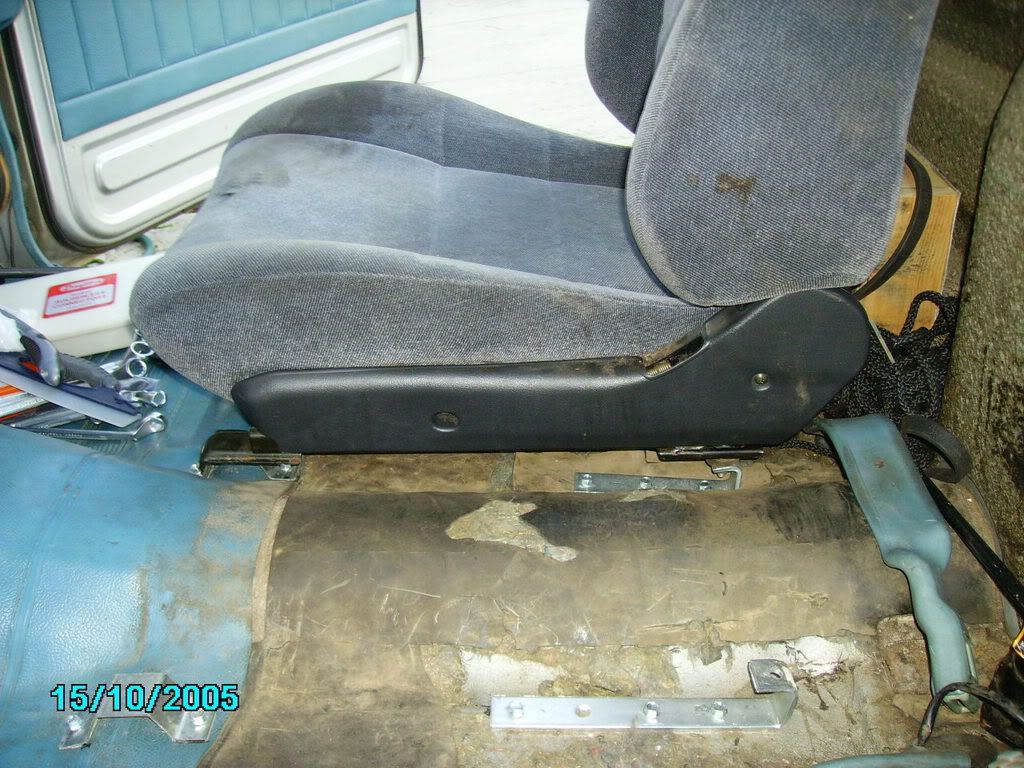

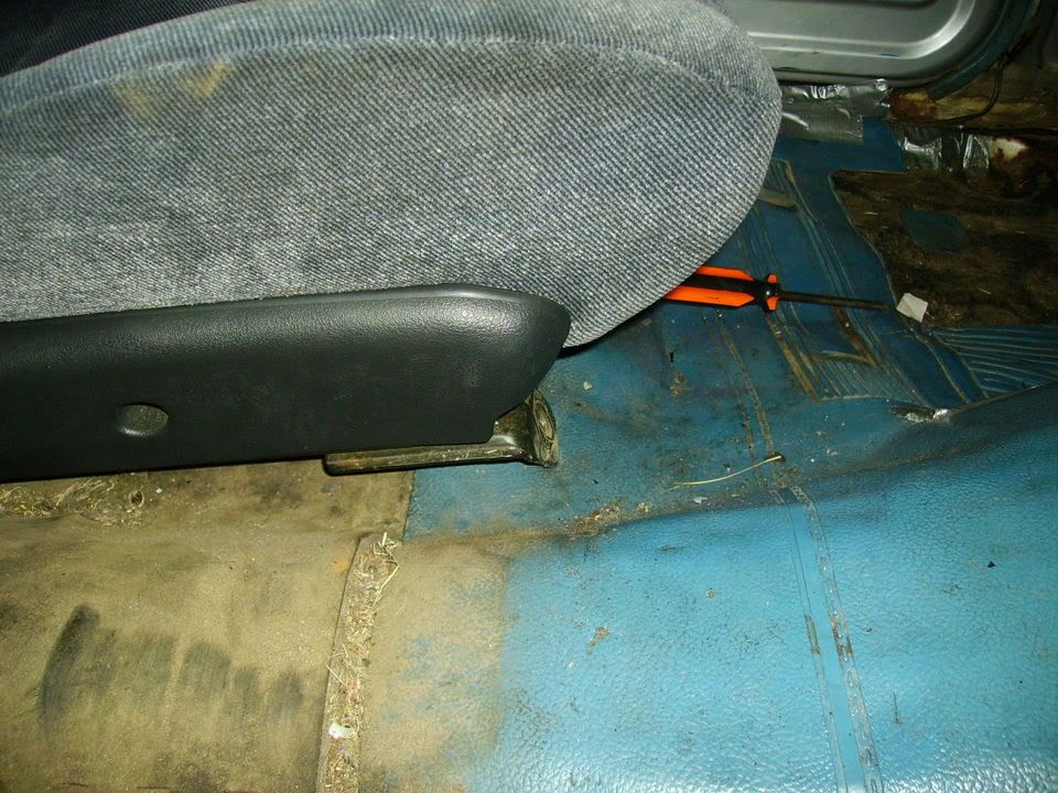

Place seat in position you would want it. Preferably nearest to the holes of the old seat.
Step 3:
Using hardware from removal of the old seat and proper bolts-nuts-washers that you should buy, install your seat.
Image (the dog looking at us like we're nuts, but he's the one with crazy hair)[/img]

Wow, I need to update this, and thank's for offering to help but they're in and they feel great, now it's a LUV Sport. BTW I was looking though a parts book for my truck over at T.L.Chevy and the Sport stripe kit is orderable but I didn't look up the prices or anything.

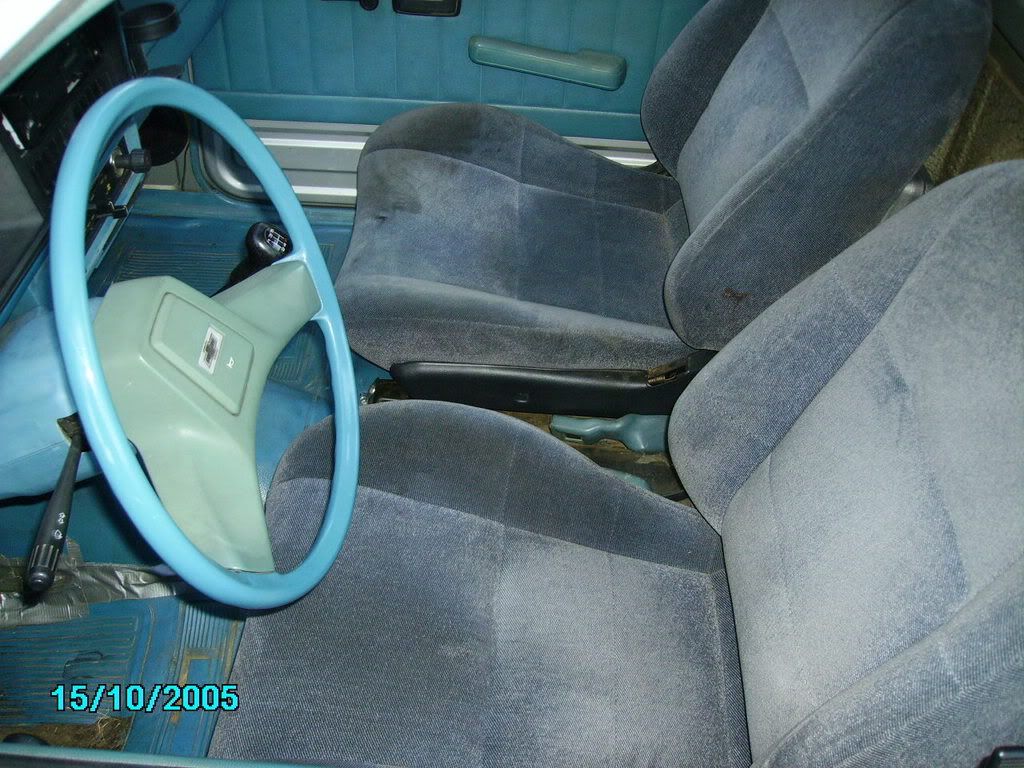

you should post a pic of the buckets inside the truck, I was actually looking at a set of the same seats for my 77 luv. would be cool to see how it looks before I decide on what seats to get...thanks
Limes? What limes?
PostPosted: Thu Nov 24, 2005 7:38 pm
Posts: 993
Location: Winston Salem, NC
Updated
