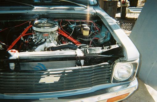

Are you talkin about the piece that is missing in the front of this truck?
They usually cut it out, so its easier to get the motor in, or out. Im sure you can fab up something nice to replace it.

yeah that's what I'm talking about. I think that's what we're going to do, hopefully in the next week or two!!

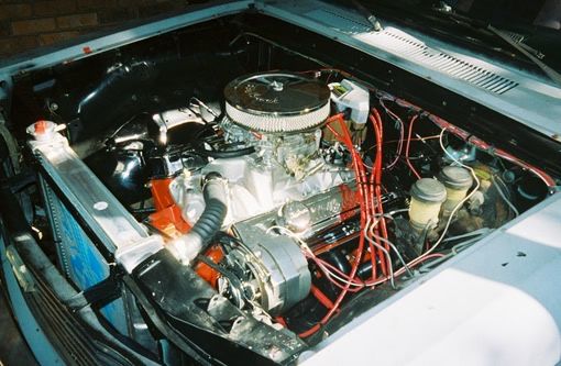

Hey Jess - I finally got the 350 in mine and when I went to the board I noticed you hadn't been posting much anymore. I'm glad to see you're back on and working on your truck again - us ladies have to stick together ya know. Anyway, here's a picture of mine. We just bolted in a piece of steel where the hood hinges used to be to hold everything together and to support the radiator and front grill. Hope this helps!
Martha

mjboyd, that motor compartment looks pretty clean!! Good job!!!

Thanks, Luvnit. It was a four month process but I'm drivin' it now every day and luvin every minute of it. I'll be posting some newer pics hopefully next week that shows how everything finally turned out. It's really strange to drive because I've gone from my daily driver of a lifted 77 Wagoneer to the luv -
and believe it or not, the Wag gets better mileage than the luv! I've gone from looking down and running over people to looking up to make sure I don't get run over :o)
