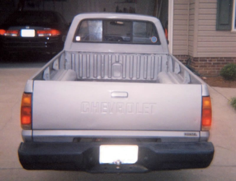

I painted my chrome trim around my lights gloss black.
