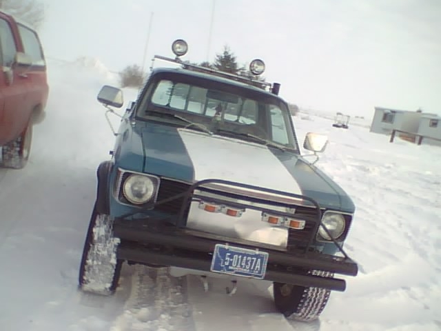

Ok after I replaced the fuse box and the fuel gauge sending unit with a replacement and the gauge reads about what i figured should have been in tank as long as its just sitting loose on the top of tank but as soon as i put a screw into the mix gauge slams up to beyond the full mark and stays there till you remove screw, what the heck.......?
possible ground problem???
not sure thats pretty weird.

Nope not a ground issue and not a ghost either a jap that couldnt read color code on wiring diagram the donor truck had same color wires but reversed apperantly took a gamble today and reversed the wires and what do you know works now,
