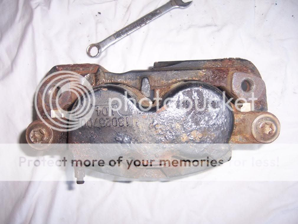

I am doing a disk brake upgrade on my LUV. I have gotten Front rotors and calipers from a 2000 Silverado. I will be using them on the rear of the LUV. The rotors are 12" and the calipers are HUGE.
Just for reference , the wrench in the picture is a 1/2" craftsman wrench. I bought these calipers from ebay for $19.99 each with $13.00 shipping each. They are twin piston.

What I am thinking is that if the rotor sit deep enough on the front hub then I could make a bracket to fit them on the front. I am going to test my theory this weekend hopefully and I will provide pictures if anybody wants them.
But some ideas for a good (read BIGGER) master cylinder would be welcome.
