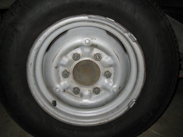

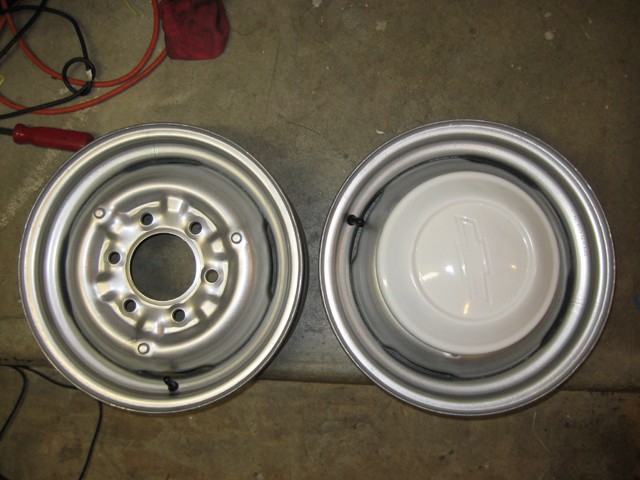

So, I got around to doing some rim painting. Decided to unmount the tires since they were spares, my truck came with two snow tires. Anyway, I used VHT Chevy Rally Silver that I got from Summit. Before painting, I sanded the rim with a fine grit sanding sponge that I got from Harbor Freight. Sanded, blew the dust off, wiped with denatured alcohol, then put on 2 coats on the back and 3 on the front according to the directions on the can. I found that 1 can is not quite enough for 2 rims. I believe I will end up buying a total of 3 cans for the 4 wheels I will be painting. I also painted the hub caps, I used Duplicolor Olympic White. They were prepped in the same way as the wheels. In either case I didn't really sand any paint off, just the gloss so the new paint would stick. I feel it came out pretty well, and the silver paint does a good job of hiding the scratches I made from manually unmounting my tires. I've included a 'before' pic that shows the average condition of the wheels.

Looking good. It is now time to paint the chevy Bow-Tie
 Post subject: Re: Painting your rims
PostPosted: Sun Feb 22, 2009 7:32 pm
They turned out good.

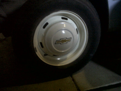

Finally finished this project

Looks real nice. Did you use the aircraft paint stripper? Did you get it from Wal Mart?

I used a few brush on the rust spots. Then used sandpaper and steel wool the do the rest of the prep before painting. I used Duplicolor paints.
