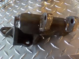

the origional bracket will not accept a delco alternator without modification. the bottom of the stock alternator has 2 small ears on each end and the delco 1 wire alternator has 1 long mounting ear centered underneith. i was able to make a mount from 3/16 angle steel and attached 1/4 inch ears drilled to 3/8 for a thru bolt for the lower pivot then welded this onto the origional lower bracket assembly while keeping pully allignment as close as possible. after a little grinding and testing i got it to fit almost perfectly. all i need to do now is buy a longer alternator belt and grind a little more metal off the bottom of the tensioner arm so it clears the top of the alternator with room to secure the bolt. since the alternator is much larger you will not get a full travel from the tensioner without modifying it a well. once done i've got about 2-3 inches of travel for the tensioner which is more than enough if you get the right belt.
lastly keep in mind your welding steel to cast iron. you need to heat up the cast before you weld it and let it set and cool on its own... this means no dunking it in water!!!

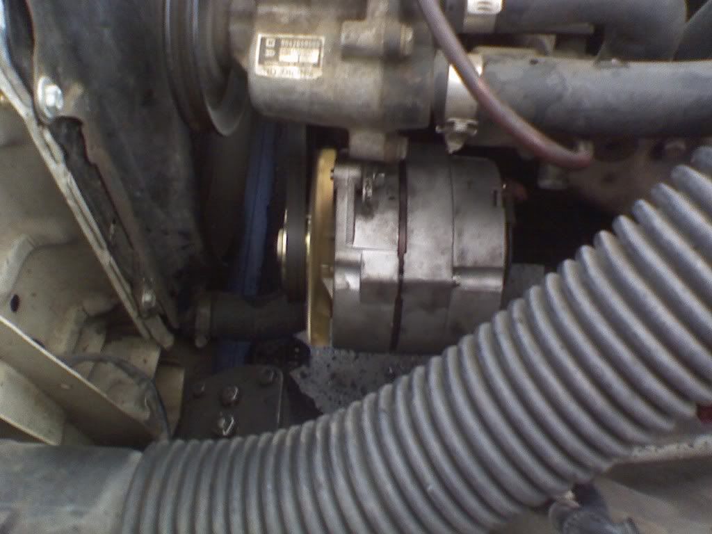

ok... here are some pics of the modified alternator bracket hope this helps somebody else too
