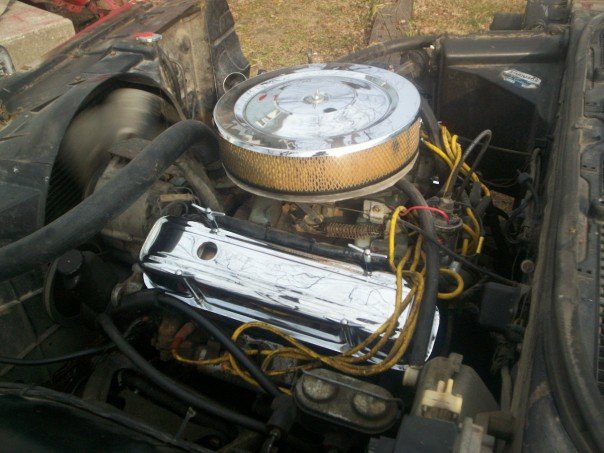

here's the bop :smt031
File comment: 400 vs. 400
Juice
