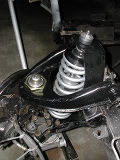

The one with my thumb is were i cut out the top and will weld on the new top with the new hole drilled to the outside about and inch toward the tire. No special bracing needed. Shock mounts in original bracket on the bottom.
Just weld trim and paint.

Ok the truck is getting laid down on coils this weekend.
Only question would be if the center is cut out from where you stopped cutting on the side would it affect ithe strenght at all?

wouldn't think so as it is just thin metal and you have the back side of the pocket still intact on the frame. Just don't get into it. i just left mine for now and smashed it flat against the frame.

ok for now I think I will do the same as you and just beat it against the frame for clearance. I actually cut a 1/2" by 1/2" section out of the bottom all the way across so cutting the side up will not take that long.
Also the hole you drilled in the new plate was an inch out from where the orginal hole was before you cut the top section out.

Was looking at the pics that cat had on the other post with mine. The eyelet mount will be easier to get the shocks off and on if you need to. Mine is simpler to make but will take longer and more work to change. Might still end up doing the eyelet but I will lose my 80 bucks for the stud conversions.

I just wanted to say thanks for the How to. I mounted the first coilover this past weekend. Just need to weld the tabs on the top and I can have 1 project on the truck checked off.

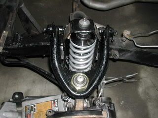

One side done, just need torqueing and paint.
Newe upper and lower ball joints. I got the lowers off ebay for 32. oo shipping and all for the pair. Quick and fit good.

:popcorn: Checkin this out . Could this be considered bolted in stock location?

Pretty much. The bottom is, but the top had to be moved to the outside approximately and inch or more. i cut the top of the mount off and rewelded a new piece of slightly longer steel and redrilled the hole on top. You really wouldn't have to cut the top, Just weld a new piece on top of the old and brace the sides a little.
Check my other posts for pics. :D

Hotrod, I used a set with the eyelets and fabbed up a mount to bolt them up that also moved them out to get by in a dirt truck before. :wink:
