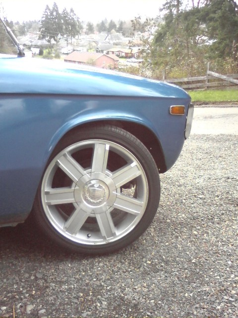

I know this is an old post, but i wanted to clear something up.
the 18" Escalades fit like a dream, and you DO NOT HAVE TO BORE THE CENTER!
I got mine a couple days ago and the caps even fit on in the front without any machine work.
they tuck nice to!
i included a pic of the ones i am talkin about

Posts: 346
Location: Illinois
I'd like to clear something up also! Those are a diffrent year wheel than Bagged79 has. do you know the center bore demensions of the newer eskies? I had the same eskie wheels as Bagged79 has on my Nissan and they HAD to be bored. they used the same center bore on the older caddie wheels as they used on the older Z71 wheels and THOSE MUST BE BORED TO FIT!!!!

sorry i dont know the exact deminsions.
But ya your right you have to bore the 17's.
I was just wanted to let people know the 18's fit.
To bad the grease cap sticks out so much huh
