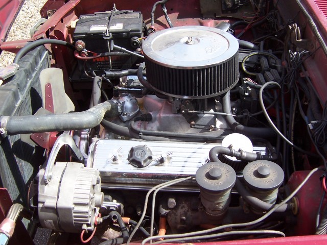

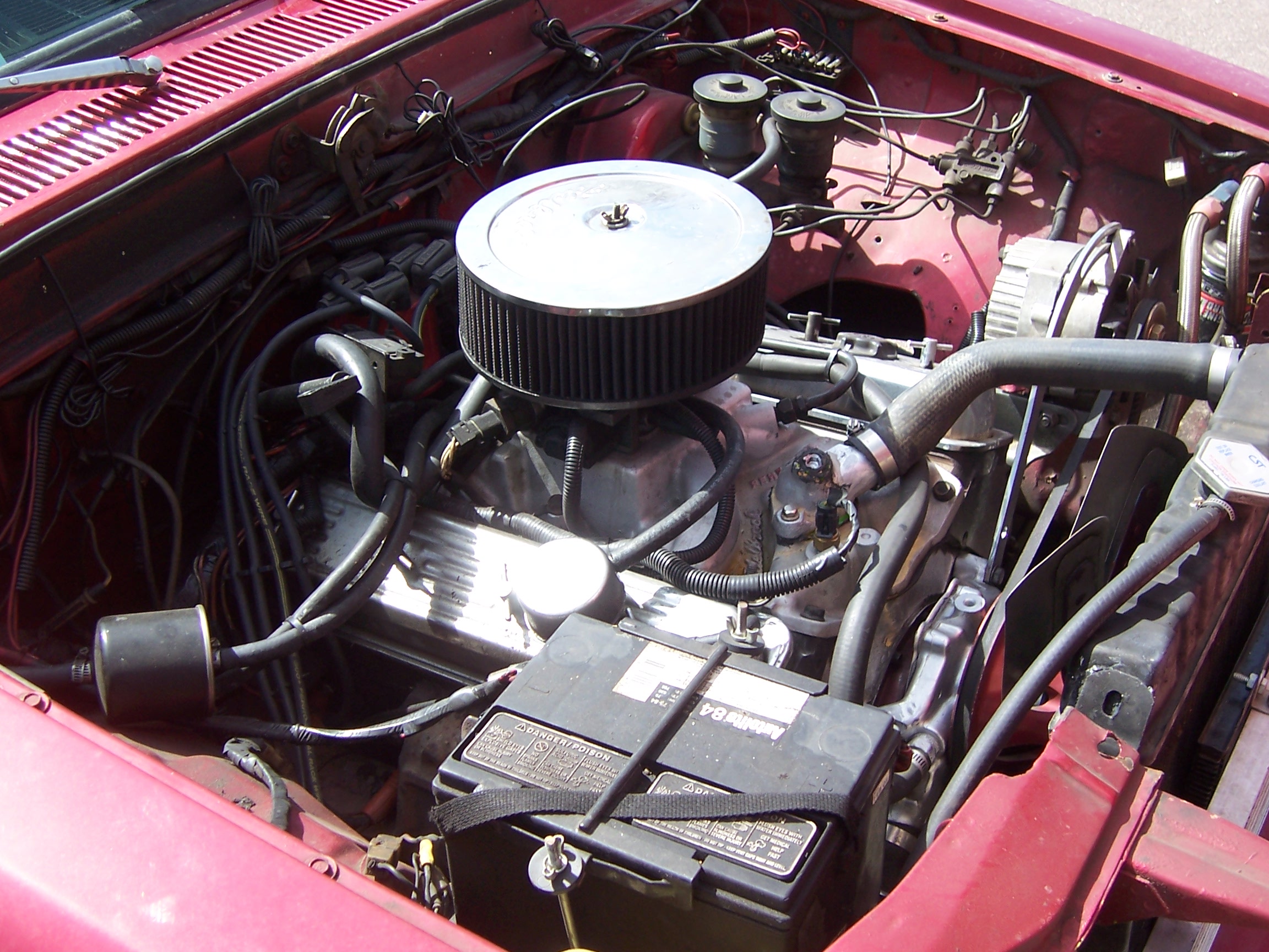

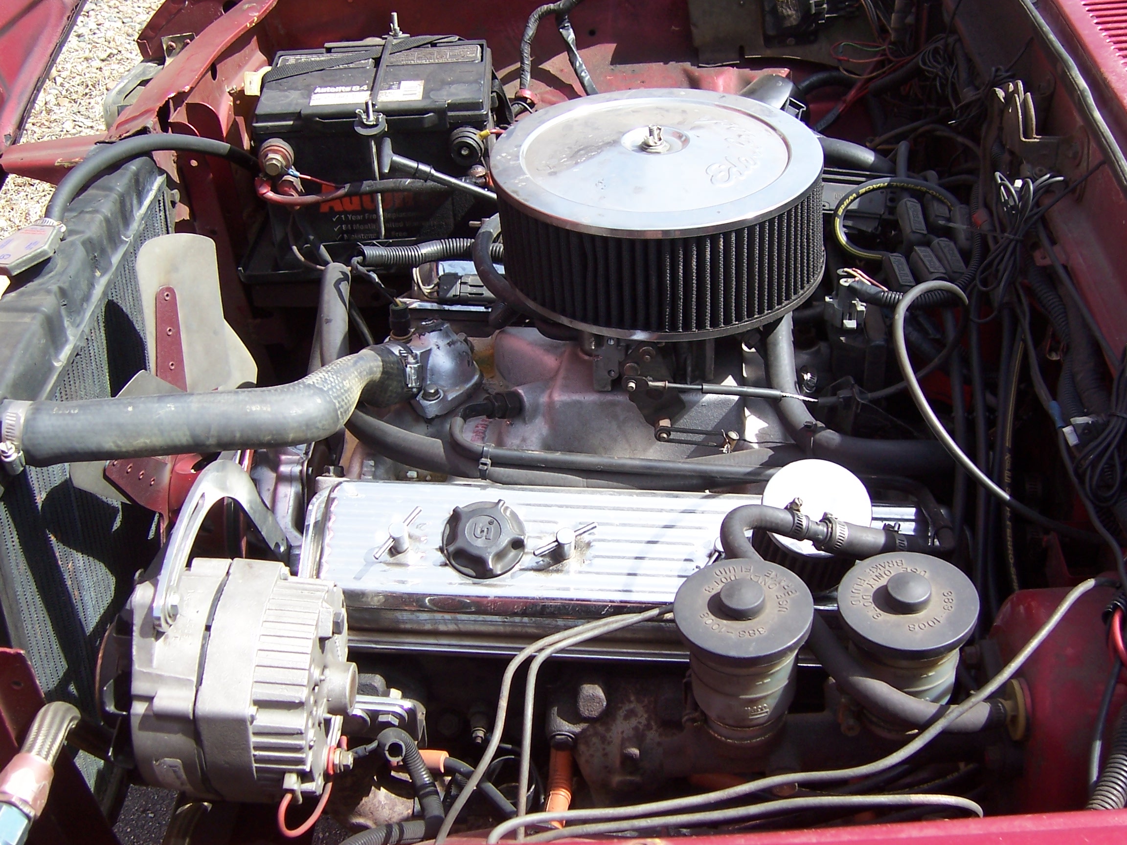

here is how mine is set up with the stock size radiator
PostPosted: Wed Apr 02, 2008 11:31 am
Posts: 641
hey will the stock radiator work for a v8? like i just got mine re done and dont want it to be a waste :(
PostPosted: Wed Apr 02, 2008 5:14 pm
Joined: Fri Dec 29, 2006 1:09 pm
Posts: 45
Location: colorado springs
i believe mine has one more row than a stock one does but i still run cool
