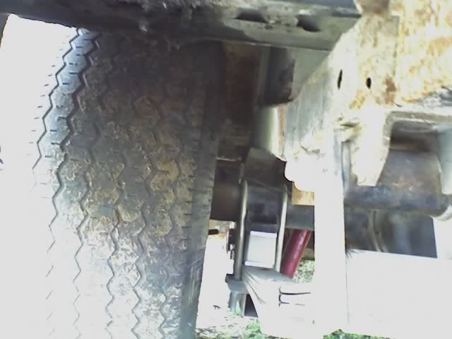

YEA!! Someone other than me with a luv in CO, finally! Anyways, I used 3 inch blocks and picked them up from Autozone.
Darn, i wish you could see the back of my truck in this pic, but maybe it'll give you an idea. The tires are about 1in. from the fender outside, but i'm also running 295 50 15s

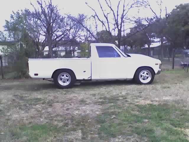

Here is mine with 3 inch lowering blocks and 28 X 10.5's.
