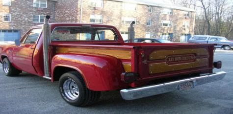

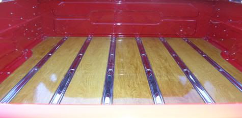

Here is a few pics of our truck, the only thing it hauls is ASS...
Bed wood
http://i70.photobucket.com/albums/i98/s ... CN0629.jpg
Side View
http://i70.photobucket.com/albums/i98/s ... CN0627.jpg

What kind of wood is that in that Dodge? That looks good. Might be a better idea than cedar.
1980 LUV Mikado 4X4
2003 Chevy S10
PostPosted: Thu May 25, 2006 7:15 pm
Joined: Fri Apr 21, 2006 7:42 pm
Posts: 135
Location: Upstate New York
That is oak, it is all in the way it is finished. That wood is 8 years old and it tied for first place ( Best bed wood ) with a brand new set we made for someone else. Take your time and be Anal about how it looks, keep it clean and dry and it will last.
