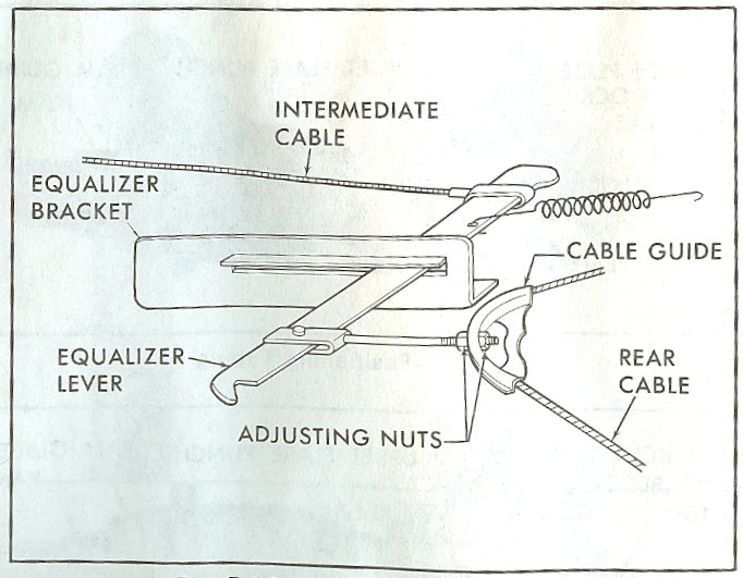

From the lever to the crossmember hookup . This seems to be a jacketed cable with a mount tab that goes somewhere and adjustment furrel that looks to go through some sort of mount or a hole in a crossmember . It actually looks as though it has a mount on both end with an adjustment on one and a tab with 2 mount holes for the jacket. I have spent alot of time on my back looking at this one and I am missing some thing . I will probably feel like a moron when I see it in place. thanks .
PostPosted: Fri Sep 01, 2006 7:04 pm
Do you have this picture?
PostPosted: Fri Sep 01, 2006 9:47 pm
I'm swapping engines tomorrow. I will have the truck up on jack stands and wrote myself a note to take pics and post em. So I'll get them up tomorrow. :wink:
PostPosted: Sat Sep 02, 2006 12:16 am
Ben the intermediate cable from that picture forward is what I need , but thanks for the picture I have all this hooked up just like that and already tied to the 9". That intermidiate cable is all thats left . The previous owner must have cut some brackets off.
Ron even if you forget the pics a good description will help me out as I bought this thing dis assembled .
PostPosted: Sat Sep 02, 2006 12:39 pm
The intermediate cable goes from that picture forward to the lever that is attatched to a pivot or "bolt" on the passenger side frame rail about 6 inches from the fire wall. It would hook to the bottom of the lever, the top would hook to the primary cable coming from the fire wall.

Rondog and Ben thanks for the pics . I was trying to install the clutch cable where the intermediate ebrake cable goes . I ordered the correct cable from the auto parts today . Thanks to the technical support from here I got that little hurdle solved . Thanks guys
