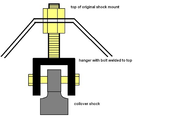

what do you think of this for a coil-over mount? I am thinking of putting rubber bushing on the top like shock had???? any input is greatly appreciated

i wouldnt sugggest the big space from where Actual coilover bolts up to top of shock tower! looks like a hanger bolted to the shock tower down to the coilover. to much stress would be on that i would think! hanger where it bolts to coilover should be bolted or welded to shock tower minus the exstension! :wink:

ah yes thank you all this is prototype stuff I am doing here haha!

I ended up adding some heavy wall box tubing to the hanger welded it all the way around and cut out top plate and will finish up tomorrow and flush it up. it will be better I don't know how I got talked into building that other setup glad I did not!

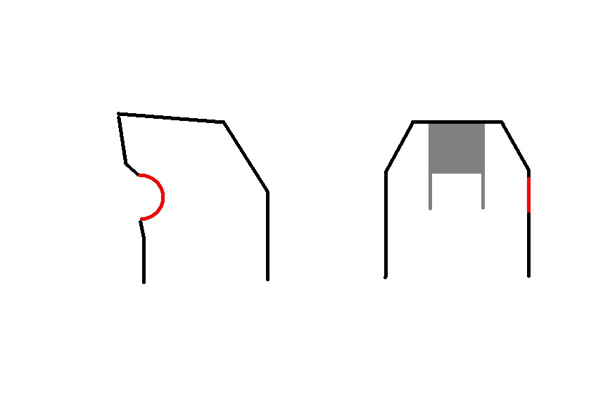

heres what i ended up doing today i welded the sq. tubing flush to the hanger and then welded it to the top of shock tower and coped out a spot in front to slide bolt in and out I used 1" pipe looks good! my dad won't let me use his camera so I am stuck with mspaint which I don't mind

yea that looks better check this website out it is mytmouz he is a member of luv truck his coilover mount is similiar to yours
