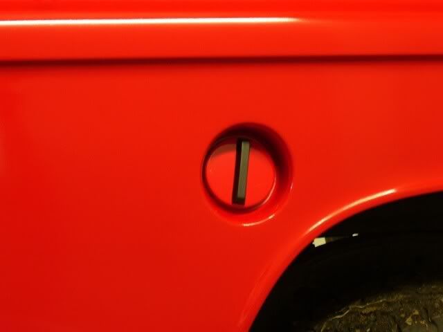

 Post subject: Buffing
PostPosted: Tue Mar 20, 2007 7:14 am
Posts: 1180
Location: Brownwood Tx
Here's a preview of the buffing taken with my cell.
Notice the overhead light reflection in the first shot, the second shows a little of the surface before buffing in the lower section of the frame.
Hope to be finished this week.
