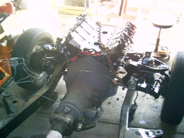

got em on and rolling with s10 spindles and ball joints!

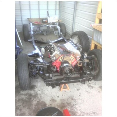

another pic

thats nice brandon how did the s10 spindle conversion go?
 Post subject: Re: My coils
PostPosted: Thu Oct 02, 2008 10:40 am
Posts: 259
Location: Murfreesboro, TN
well lets just say it took a little time and fabrication lol after i made ball joint plates for bottom and welded ball joint in and drilled hole to bolt top ball joint in and tach welded too ....the spindles bolted right up like factory ....check my other posts 6.0l ls1 lq9 swap it has all the pics!
