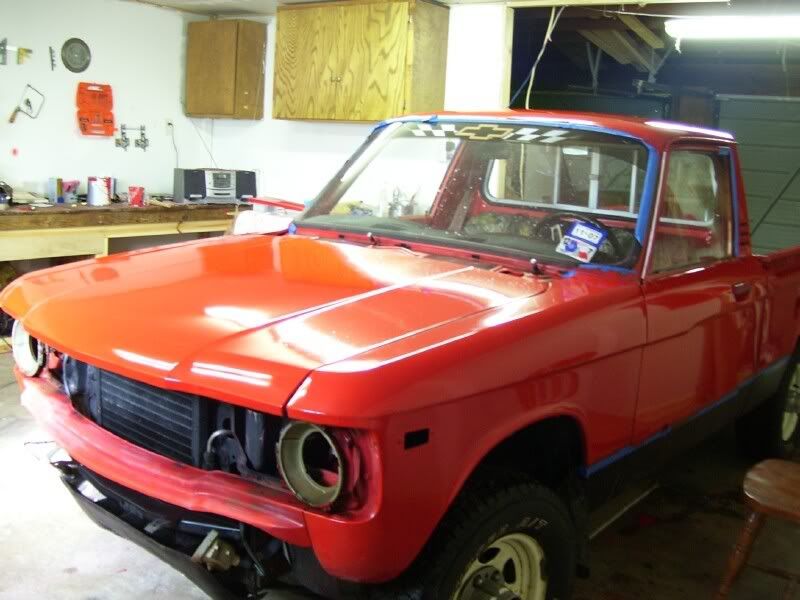

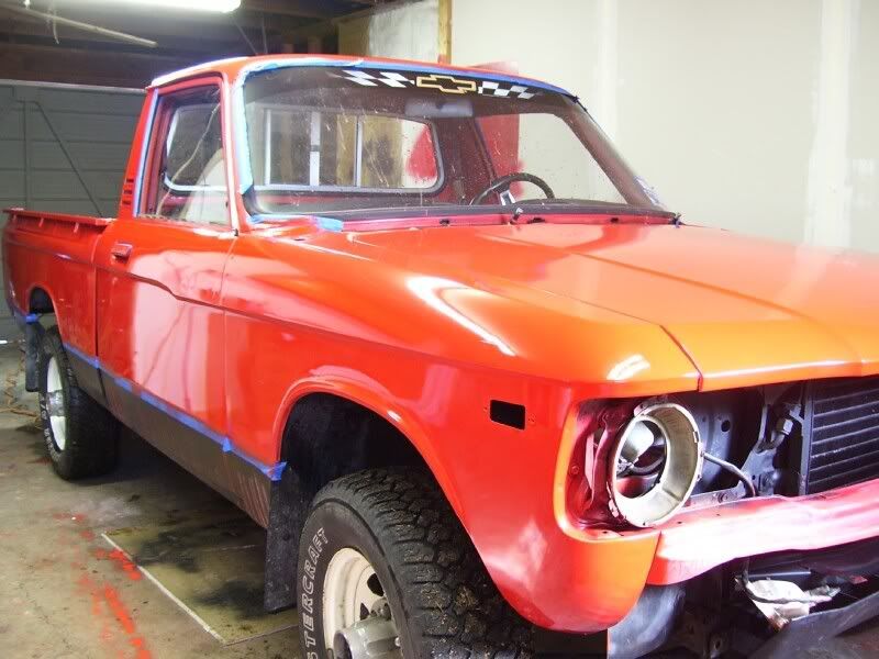

Afer wetsanding and 3rd coat.
Time to dry and go cut some mesquite.

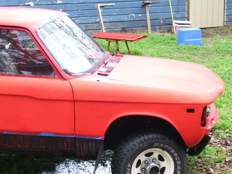

Looking good, I'm going to have my paint tinted at the store, I think I am going to go with a Nissan burnt orange, that used to be on my old 720 I had. How is it filling, since it isn't down to bare metal, and did you wipe the body down with mineral spirits to degrease it?
 Post subject: .
PostPosted: Tue Mar 13, 2007 1:56 pm
Posts: 1180
Location: Brownwood Tx
I think Rustoleum makes a pretty good orange too. Filling nicely, and roger that on the wiping down with mineral spirits. Didn't have a whole lot to fill, I did a good job filling and feathering out scratches overall, have a tiny few left...but hey it's a truck.

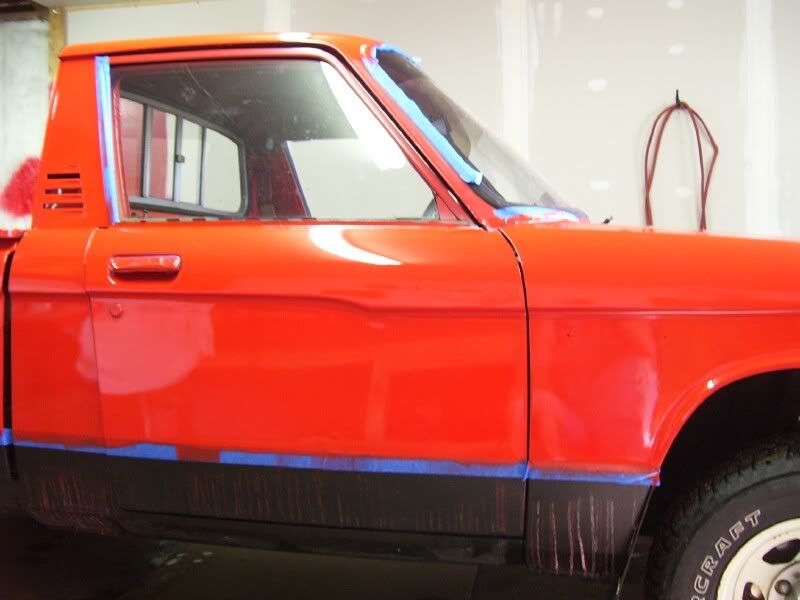

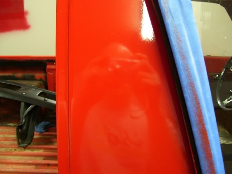

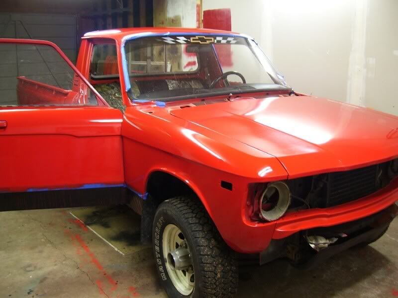

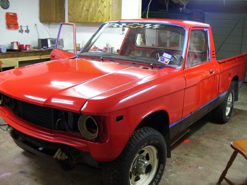

Here's some 4th coat pics, not too much difference from 3rd, except better coverage.
Note to self, the next time the wife comes out to the shop to give me an American Idol update...lock the door. Bugs love flourescent light almost as much as they love fresh sticky paint.

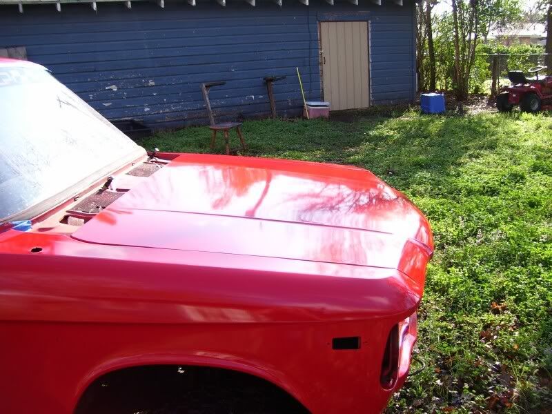

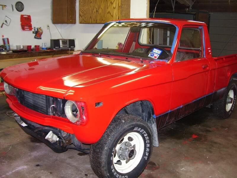

Just finished the second wet sanding after letting the 4th coat dry. I would like to stress the importance of surface prep and practicing with the roller and proper paint-spirits ratio, and taking your time. Makes the horrible chore of wet sanding alot easier, after 4 coats I have almost no orange peel or runs to deal with, the wet sanding went great.
more pics

 Post subject: 5th coat
PostPosted: Wed Mar 14, 2007 6:46 pm
Posts: 1180

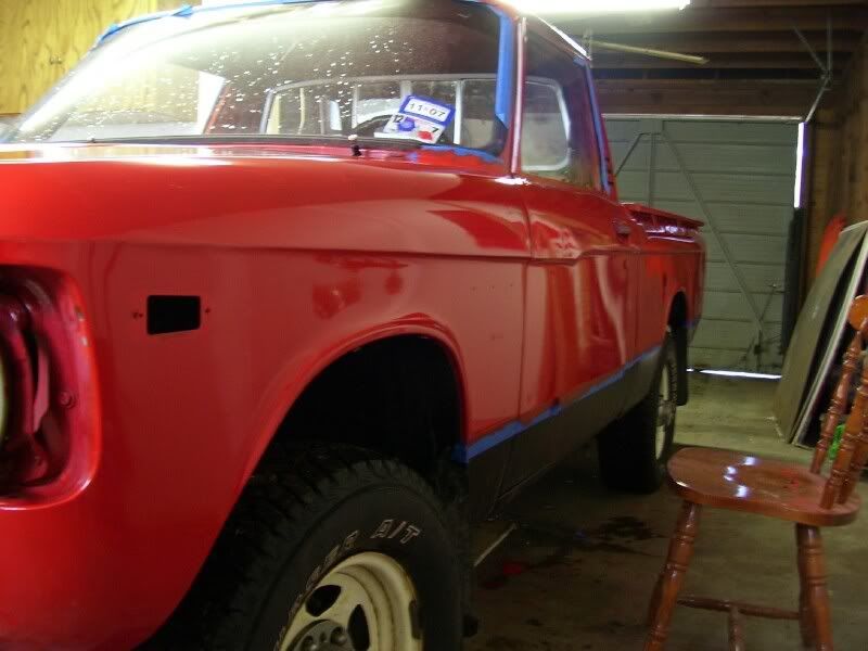

5th coat, man, that RED is starting to pop!
The runs and spots on the floor are from wetsanding, not paint runs :D
