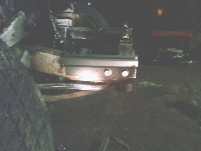

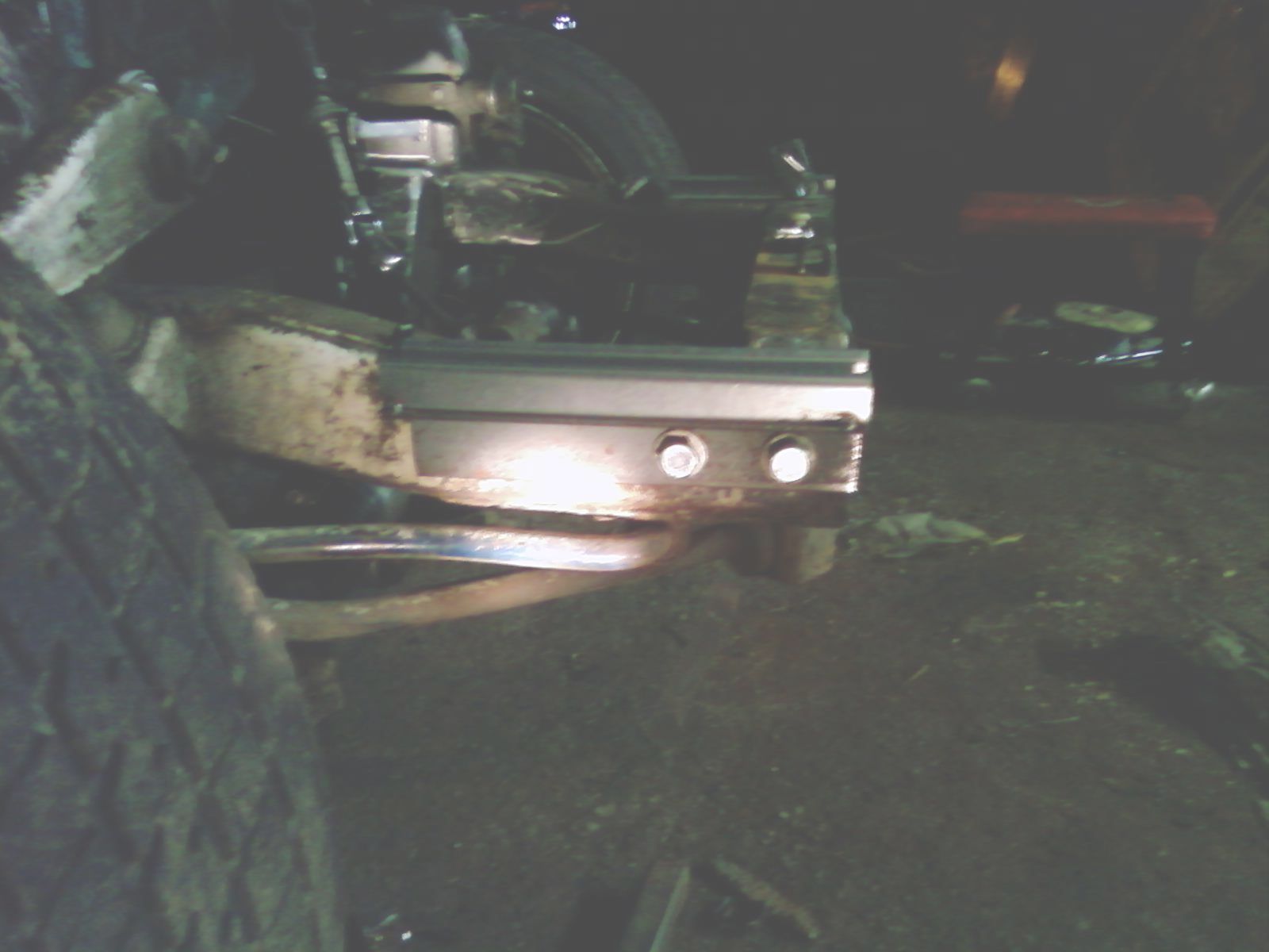

ok now I am on to this for right now on my project. I decided not to use the sliders that I bought I did a lot of thinking yes they will work but they are susceptible to the debris from the roads and will wear out the ball bearings.
so the new plan involves solid rubber guide wheels ball bearing in a track that will all be able to bolt on to the frame and take some of the headaches away and I also have an idea to keep the whole setup from jumping up and down from dips in the road should turn out pretty nice. should have pics of the work I have been doing lately.
PostPosted: Wed Jan 07, 2009 9:51 pm
Posts: 445
Location: Roseburg,Oregon
ok I have some progress not much but a good start. excuse the pics they are not that great without flash I tried to brighten them up a bit
but this is of my track connected to a bracket that goes to the frame (along with the rollers)
