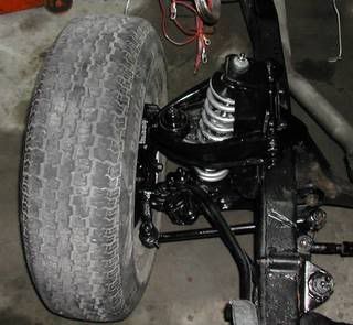

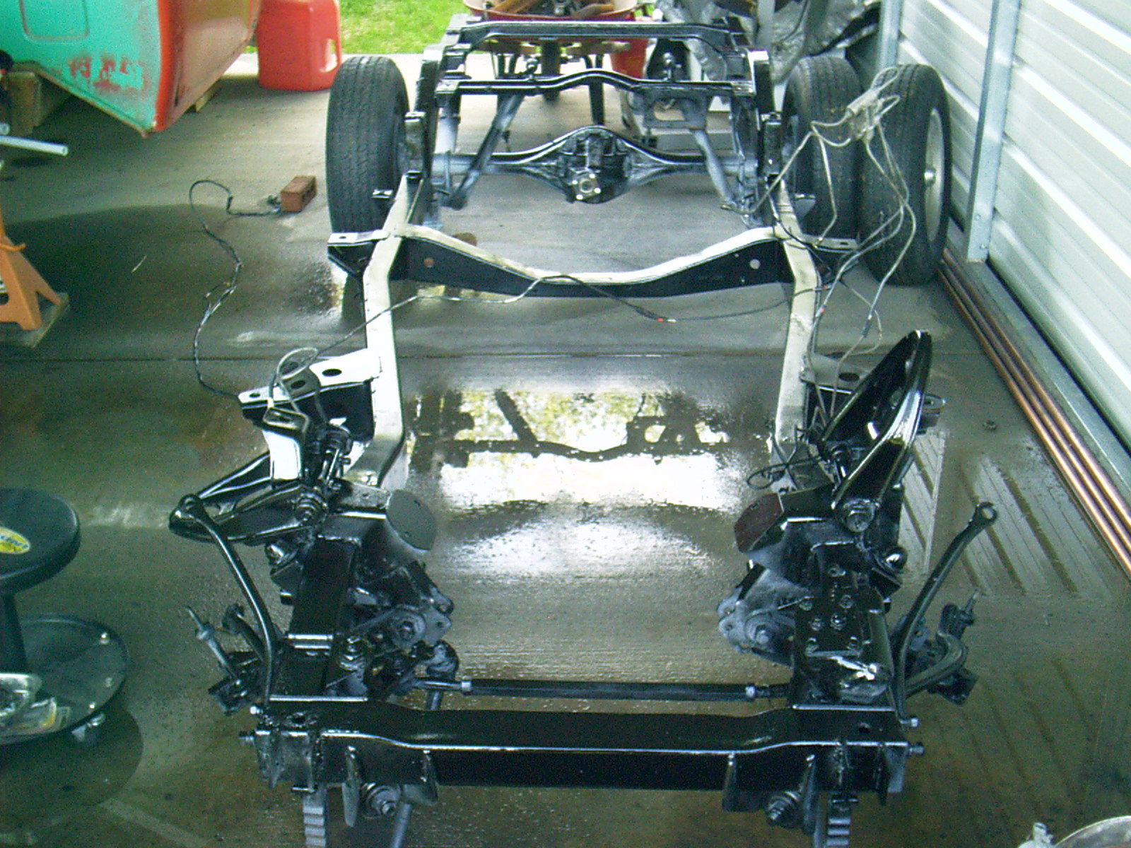

:lol: looks like my frame minus the coils i dnt have money for!lol lookin good

Yep, hey! what did you do with the piece of cross member going from sise to side to each lower control arm. Did you just take it off to paint or are you leaving it off.
Looks like it adds strength and stability to the front between the frame. It just bolts on. I need to paint mine plus the tranny mount.
Did you cut your bumper brackets off or are they supposed to unbolt. Mine are welded on but I am taking them off.

yeah i just took it off when i was test fitting the 6.0 , it fits nice about 1/4 in front of the oil pan. bumper brackets just unbolted for me i made a tilt front end so im gonna try and get a front valance. i still got to make a tranny mount also.

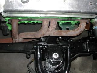

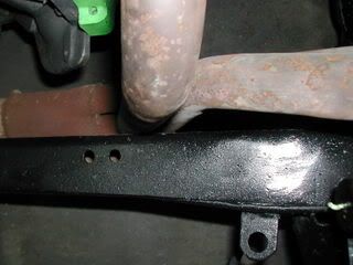

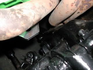

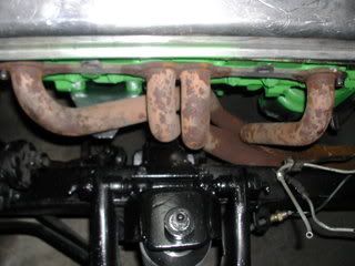

Here is my headers I am trying out. Might swap my 4 10 gears for them. They are truck headers. They rub the frame a little on the passenger side and the cross and the mount below the control arm. Driver side fits great.
Gonna get my motor mounted this weekend I hope.
Long tubes will definately work without the torsion bars.
Shorties are going and if nukeday I think who was wanting them can have them now. Will send the curl at the pipes and all

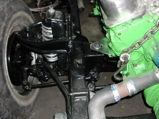

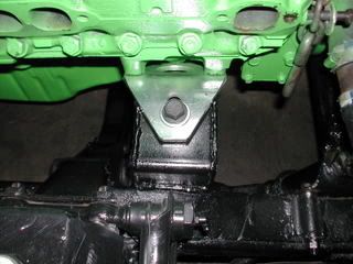

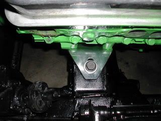

Mounts are on and now I can get to business. i messed up on one side and the friggin mount slipped and I didn't check it. Have to use a 3/4 in spacer on the drivers side. No problem though. I am using 1/2 inch grade 8 bolts.
