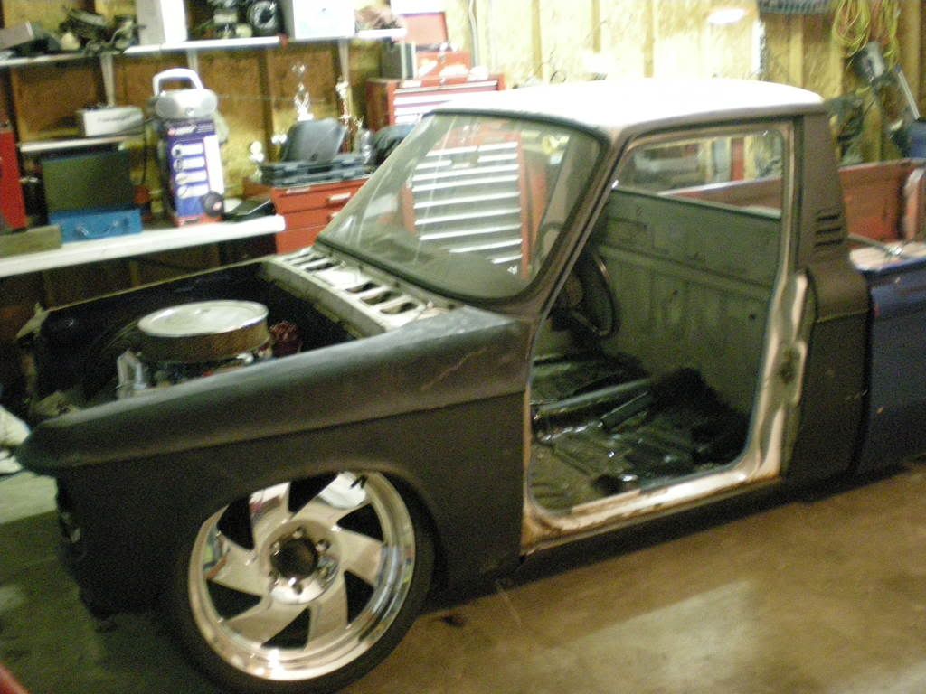

Just wanted to post some updated pics. let me know what ya think.

Dude that setup looks SO slick! I think it makes it look kinda like a hotwheels car! Hmm, wonder if anyone has a Luv hotwheels? Keep it up!

You gonna Z the frame so the front will lay out? Lookin good man

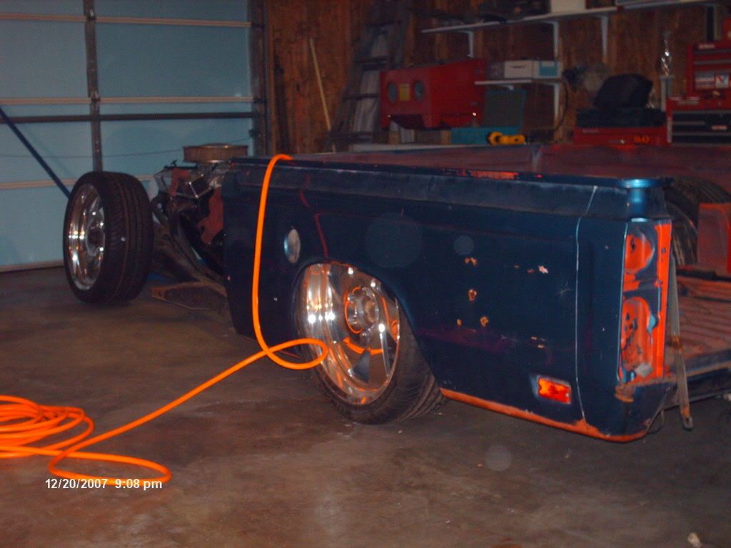

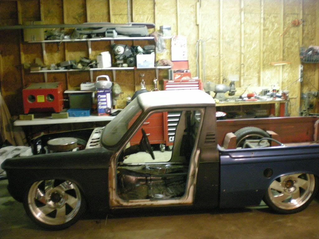

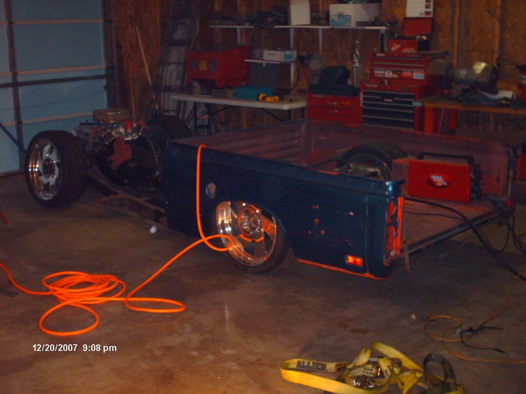

I think I'm going to run the front just with the upper control arms I made and the bags. I got over 20hrs in building the custom crossmember and tranny mount now. If I Z'd the frame I'll have to cut another 3-4" out of the firewall on top of the 2" I already cut to get the headers of the ground and have the truck lay out. The other thing is if I Z'd the frame I would not be able to run the stock blower motor .Not to mention cut the complete fenderwells out including the core support to cab supports. I know with the headers and me being 6'3" I need as much room as possible in the cab. Now I have the tranny and driveshaft coming up another 2" into the cab.

Those wheels look nice! The truck also...

That is awesome! Is it difficult to steer with those huge wheels?

Thanks for reposting them. The pictures look alot better. The truck seems to steer just the same as it did before. I think it steers the same as it did before with the V8.

hey ridgeway! are you using the stock reaar end??? 8O with the v8 up front? :?

Hows the front end going to work with all that camber on the wheels??? Obviously your going to lift it to drive to so the wheels will turn. Can you give us some pics at ride height.
Seeing as the 4 link arms are so long does it have much side to side movement??? If so you could look at making up a watts link for the rear end. That would keep it tight and straight at any height. Way better than a panhard rod.

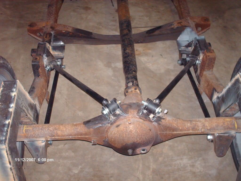

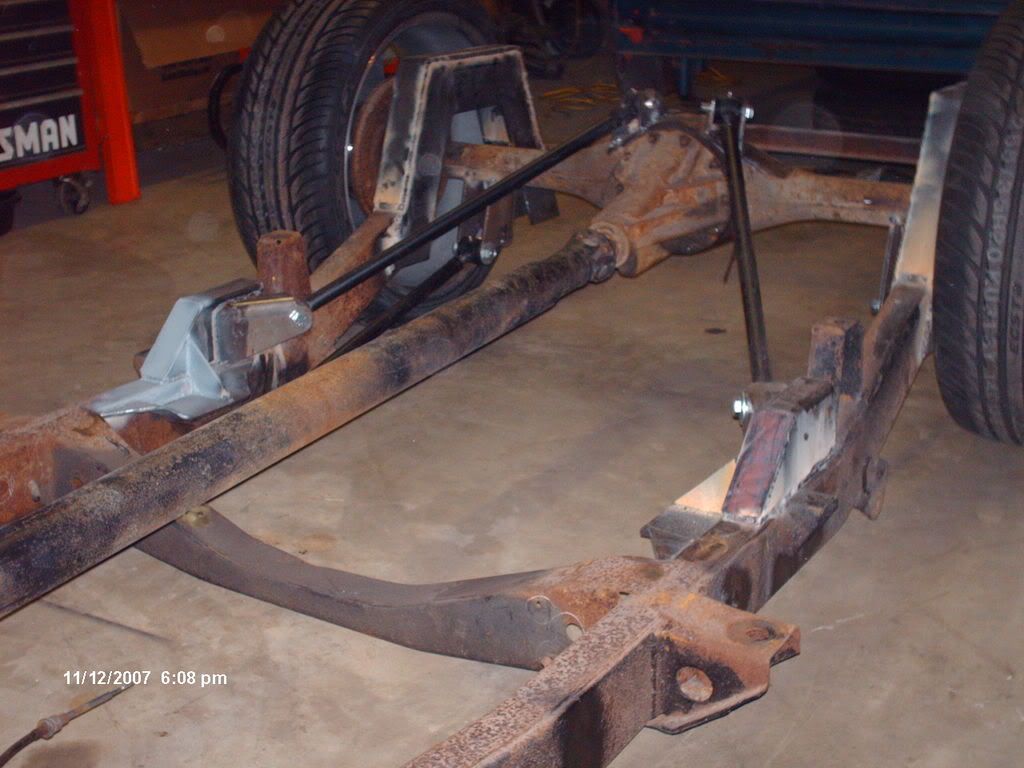

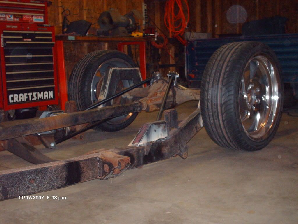

I am using the stock rearend housing and third member. The axles are fullsize mosers cut down and resplined to fit the Luv rearend. The third member was gone through about 300 miles ago. The truck never hooked up with the v8 in it before so I don't think its going to now with the Spray! I never had a problem with this rearend after the moser axles went into it. The only problem we ever had was breaking the passenger side axle. Besides this truck is not going to the strip, It will probably spend it's second life at the shows and just crusin around. The 4-link I used it for heavy duty applications and high horsepower the bars are longer and big to keep the geometry as close as possible during the suspension travel. I've had b/d and bagged trucks/ cars before and the problem usually comes up that the small mini truck kits are just to small and caused suspension geometry changes when the suspension was cycled. not to mention evry weak bars and mounts.
Rodeo, the truck has no side to side movement and the truck still has the stock height alignment as it sits. when the truck is raised it will ride at stock height in the front.
Craig

Rodeo, I have not moved any of the shims from the truck when it was aligned by the shop when stock height. That means when the truck is "layed out" (on the ground) the alignment will be off, But when it is raised at stock height in the front it will be aligned correctly and all the geometry will be as if it was stock. Hope this helps.
