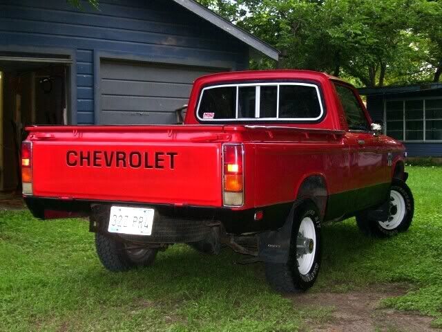

Had a situation yesterday, that I think can attest for the toughness of the Rustoleum DIY paint job I did a couple months ago...
A friend ad I were out at his deer lease clearing some more mesquite trees. We're winding out way slowly through the pasture and coming up is a group of trees that I have pre determined which route I'm gonna take through them, plan was to take this one particular low hanging branch a little wider. Well a few deer caught our attention, and naturaly I looked and watched em bound away into the brush... all of a sudden there's this horrible scraping, screeching noise filling the cab, I had drifted right up under that branch. My first thought is "holy shit!!!, way to go meat-head!!"
I stop, we get out expecting to find it gouged down to bare metal. In case yall didn't know, mesquite is a very hard wood covered in equally hard 1,2, & 3" thorns.
I hopped into the bed to inspect the cab damage, neither one of use could find so much as a scratch... just few spindly leaves and twigs in the bed.
Try that with a CC job :)

PostPosted: Mon Apr 30, 2007 12:29 am
Joined: Wed Mar 21, 2007 7:23 pm
Posts: 127
Location: Orlando, FL
8)
Dontcha Luv it 79?
Even showing ppl my car most don't want to believe the roller method works.
Either, "Shoulda done metallic" or "The shine won't hold up over time."
It's mine & I'm happy as a clam with the results.
From a few golf ball encounters I can back you up on the toughness/durability of this finish to damage ol' lodge bro. :wink:

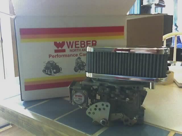

 Post subject: Weber installed
PostPosted: Wed May 02, 2007 7:02 pm
Posts: 1180
Location: Brownwood Tx
Chased down the UPS gal this morning, rushed to the shop to get the new Weber 34/34 installed. Was a fun install inspite the weak instructions. Hooked up the throttle linkage and fuel line, plugged a few now unecessary vacuum hoses, put on the air cleaner few cranks and vrooom!!
Only had to slightly adjust the idle screw, purring again at idle, now has a little roar going down the street. Can definatly tell a difference, has a better sound to it, even with the stock exhaust. Pacesetter header is next, hopefully in a few weeks.

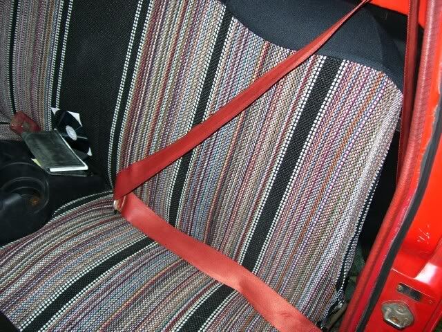

Well I was trapped in my shop most of the weekend. Tinted the windows, added a new seat cover... fits nice after removing the seat first
Got realy bored, and removed/repainted my stock wheels, look purdy
Got realy realy bored, and tired of looking at the faded usta be red seat belts, took those out and dyed them red. too easy.
