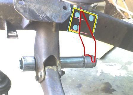

In other Luv news I got 2 sets of braces cut yesterday and I should get a few more sets done today as well as some bag plates cut. Shawny B suggested there be some plate that goes against the frame where the brace meets it since the frame is so thin. I agree and I have drawn a small plate in CAD that I will cut from 1/8" armor to go behind the brace.

I have the frame braces cut and thats the latest. Im working on some other back ordered stuff but the final design is done.
Heres the brace, .250" AR500 armor plate.

is there a reason for using the Armor Plate?
sounds like something that will be a pain to weld to the chassis if you want to go that route.... or something that might be brittle if it happened to be hit with a hard impact.
just curious.

actually the armor plate is because I have access to it. Its also not brittle and wont break in an accident. its also as easy to weld as any mild steel. no difference unless you try to drill it or if you want to shoot at it...

any thoughts on maybe welding a plate on the end of that brace?...like a "T", instead of it just butting right up to the frame and fillet welds, drill a couple holes in the plate for some plug welds and such? it may be overkill but it would make me feel safer :D
heres an edit of your pic
yellow would be the plate, blue would be the weld(outside perimeter, plug holes, fillet weld), pink would be gussets
