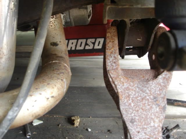

Below is a pic of the header to lower a arm clearance. The closest point is 2.375 from the outer edge of the a arm to the header tube.
On your drawing with the weld on outrigger, I notice that it attaches to the frame. The center of the lower a arm mounting point is approximtely 3.5 inches away from the frame and approximately 2.5 inches below the frame. Depending on the distance towards the rear of the truck, the starter may interfere. I can check when you get a better idea of the measurement.

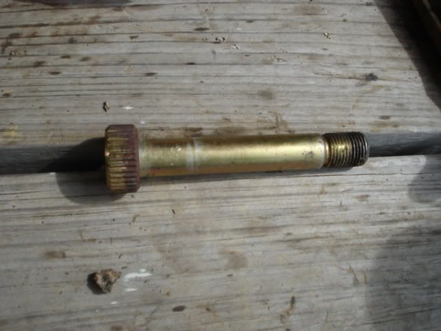

Below is a picture of the lower a arm mounting bolt. It is .625 inches in diameter.

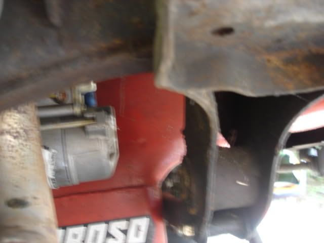

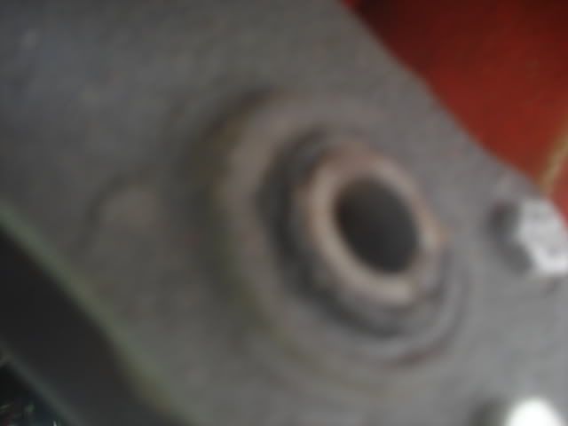

The pic below shows the frame bushing. It is 1.5 inches in diameter, the length is 2.8375

its metric so we are talking a 16mm bolt and dang near 3" long on the frame bushings.

Someone who has a frame apart please see if a 5/8" bolt will slide easily thru the supension bushing holes. Im thinking it will but Id like to know for sure before I make the threaded tubes for the arms.

Yes, a 5/8 bolt works fine. No more play with it than the stock one. Both shanks measure .625...
