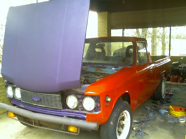

It has started. I stripped mine to the bare metal. There were so many layers on it, it was just as easy to do that as getting it to the original color. Used some aircraft remover, some sandpaper, and a grinder with a stripping wheel. It took about a day to get one side to bare metal.
Just got one side started for now. I didn't want to leave the side exposed.
I wanted the original light blue, but Home Depot didn't have it. Hell, I've always wanted a red truck. :)
Here it is after one coat.

Sweet!!
You using Rusto Safety Red? The spray is almost a perfect match to the can, works great on the spots a roller can't reach.
How many coats you plan to do?

drummer, what's on the hood? What did you prime with before you started rolling?
Looking good 8)

Yeah, it was a toss up between that and the grey.
Not sure about the coats. Just as many as it needs, I guess. :lol:
Looking good 8)
On the hood, actual automotive paint. Its about 10 years old, but it wasn't taken good care of. My grandfather had it for about 7 years and let it sit in the weather.
No primer. Just rustoleum. The rustoleum is designed to go on whatever, so hopefully it does what it should.
