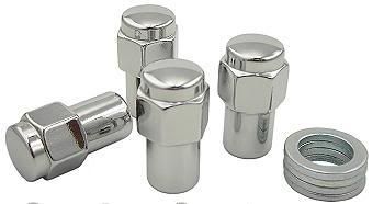

Make Sure You Are Using Long Shank Lug Nuts, Like Used With Mag Wheels.
They Are Necessary With These Wheels
They Look Something Like This
If This Isn't The Case All I Can Suggest Is To Get Some Longer Wheel Studs.

Yep those are what I have. Glad you posted them so I didn't take mine off yet.

Thanks for the picture.
