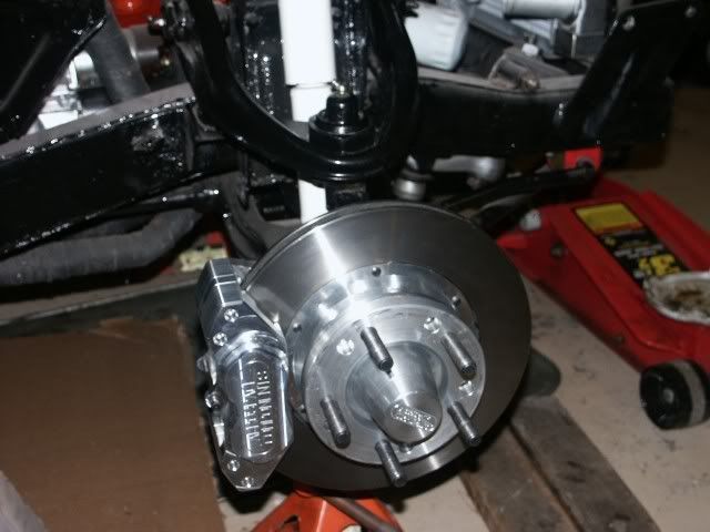

Yep, I broke down and got the front disc kit from Aerospacecomponents.com. First of all, the kit is excellent, it fits like a glove. Everything fits like it suppose to, I never had to call them for support on the installation. It looks REAL good, the bright aluminum shines.
The down side is the cost, I had to part with 7 bills for the kit. I had to make the conversion to a 5-lug setup and believe it or not this was my best option. I tried to do the Vega rotor option, I bought the Vega Rotor/Hub, the inner and outer bearing and the seal from O'Reilly's for $132, this is for one side only. I had a heck of a time finding a machine shop to do all machine work for the conversion. The best price for the machine work on both rotors was $400.00. I decided against this path and returned the parts, O'Reilly's took the items back.
If you add all of them up, $264.00 (for 2 kits @$132 ea) and the $400 machine shop cost, that comes to $664.00. The cost differential to the Aerospacecomponent kit is approx $50.
I think the $50 extra cost gave me added insurance that everything is going to work and fit properly and of course look really good. Judge for
yourself.
One other advantage, if I ruin a rotor I can purchase just the rotor since they bolt on to the hub. The Vega option would require the me to start from scratch again repeating the cost and headaches.

That is SWEET. Really nice look I think it really was worth the $.

thats really freakin nice lookin man!!

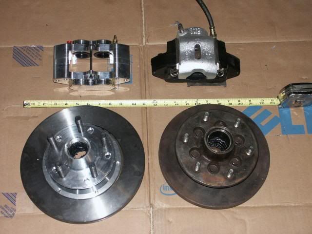

Here is a photo of the original and new disc brakes. The original rotors are about 9.75 in the newer one are 10.75 in. The new calipers are 4-piston type. What is neat about these calipers is that the pads are changed by removing the center 3" screw (shown) and pop the pads out upward. Unmounting the caliper is unnecessary. The weight of the newer rotors and calipers is about 1/2 the original.

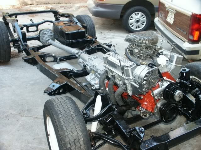

This a picture of my drive train the body is a stepside but is not ready for prime time.

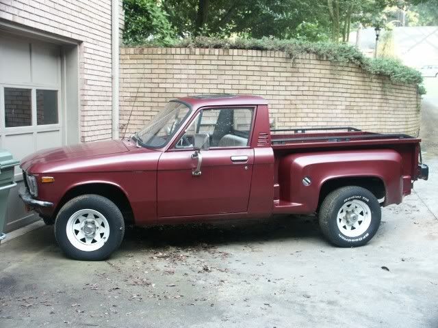

This is a pic before the start of my project. It looks okay but it is pretty rough under the covers.

So, you are backing up this upgrade with the stock LUV brake fluid system and resevoir, etc etc? No additional changes but the rotor/caliper set-up?
Is the new rotor a one piece rotor?
Backside image?
"The original rotors are about 9.75 in the newer one are 10.75 in"...
10.75 or 11.75 ?, I was looking at his site at that kit.

For this kit the rotors are 10.75" This a two piece rotor/hub , the rotor is separate from the Hub. They are bolted together with 6 bolts. You can see three of the bols (outer ring) in the comparison picture.
Yes, I'm using the same stock master cylinder setup. Since 76+ Luv come with stock front disc brakes. I'm not changing any additional parts. I don't anticipate any problems, but only the final road test will tell the tale.
