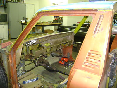

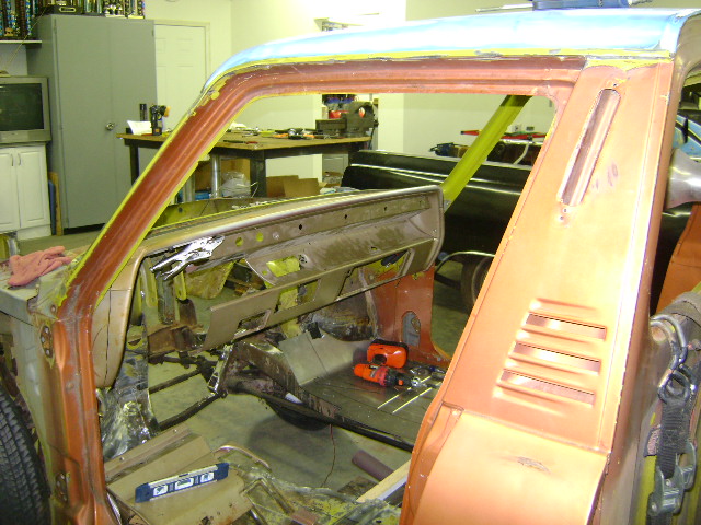

hello cleaver . look inside the cab on the kick panel and youll see a plate that is held on with a screw ,the upper hindge is the same way but behind the dash right abouve your vent pull knob , take them out and pull plates out and youll see the bolts for the doors [note the hole buy the drill]
. youll have to take the headlight bezel off to get at three hidden bolts for the fenders . the rest you can see . hope this helps
