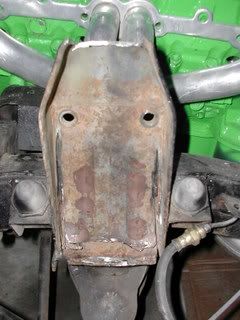

 Post subject: Re: Coil Overs
PostPosted: Mon Apr 28, 2008 10:09 am
Posts: 917
Location: Jeff City, Mo
Yes, just bolt in with the top fabbed with the new plate and hole for the stud conversion.
You can go to my other posts and see my pics of the mount.
PostPosted: Mon Apr 28, 2008 7:09 pm
Posts: 917
Here is one pic. Kinda ruff yet but will be smoothed and painted when finishes. Guess I need to put all the pics on one post or page unless one of the admin guys can do it.
Hope this helps. Will probably cut all the thin metal out and just leave the inside frame of pocket.
Like I said before though if you ever want to change springs you will probably have to drop the lower arm or take the upper loose.
PostPosted: Mon Apr 28, 2008 10:16 pm
Posts: 259
Location: Murfreesboro, TN
wow they are exspensive! 8O but i need them. thanks for the pics they help alot!
