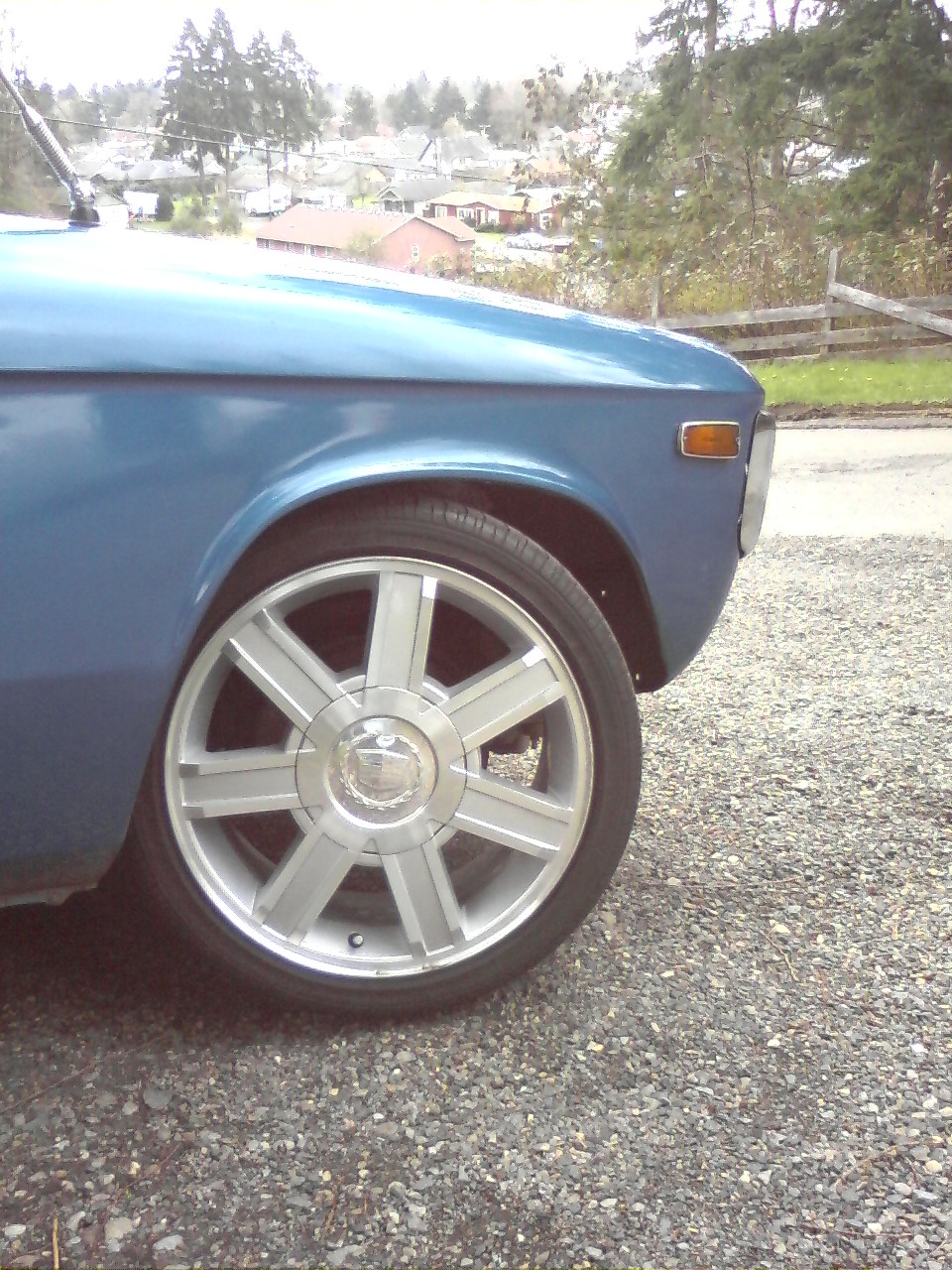

I know this is an old post, but i wanted to clear something up.
the 18" Escalades fit like a dream, and you DO NOT HAVE TO BORE THE CENTER!
I got mine a couple days ago and the caps even fit on in the front without any machine work.
they tuck nice to!
i included a pic of the ones i am talkin about
 Post subject: Re: Cadillac wheels
PostPosted: Thu Apr 10, 2008 8:59 pm
Looks sweet.
PostPosted: Mon Apr 21, 2008 3:45 pm
Posts: 346
Location: Illinois
I'd like to clear something up also! Those are a diffrent year wheel than Bagged79 has. do you know the center bore demensions of the newer eskies? I had the same eskie wheels as Bagged79 has on my Nissan and they HAD to be bored. they used the same center bore on the older caddie wheels as they used on the older Z71 wheels and THOSE MUST BE BORED TO FIT!!!!
PostPosted: Tue Apr 22, 2008 10:42 pm
Joined: Thu May 24, 2007 5:03 pm
Posts: 13
Location: Centralia WA
sorry i dont know the exact deminsions.
But ya your right you have to bore the 17's.
I was just wanted to let people know the 18's fit.
To bad the grease cap sticks out so much huh
PostPosted: Wed Apr 23, 2008 5:45 am
Posts: 346
Location: Illinois
Have you looked into replacing the caps with other ones? I was going to look into trailer axle caps before I purchased the 20" with the correct bore demensions. try looking at http://www.redneck-trailer.com/ they have a crap ton of axle parts and you might be able to get a smaller cap.
