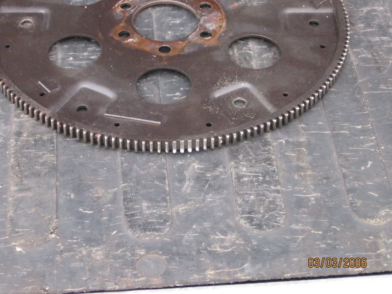

Well it's back together and on the road again. The starter works like a dream! It took 4 shim pieces on the outboard bolt to get it to fit the flexplate correctly. When i crank the engine, i can barely hear the starter.
I hate those damn AutoZone starters that are made in Mexico. Thats one reason why the flexplate wore out to start with. I got a TCI flexplate on it so it should last forever.

Here's a pic of a flexplate that didn't have a correctly shimmed starter. Here's y'alls chance to learn from my mistake.
