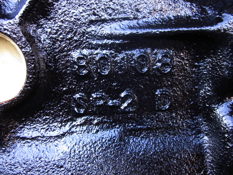

I was starting to bolt the accessories on and get it ready to install and noticed the head has "G200" cast into the front, is this typical of a stock 1980 4x4 Luv truck or was it swapped on?

At some point in its life someone else has put that head on there... wont hurt anything. Compression wont be as high though. Will lose some power but seeing that offenhauser intake I am assuming you are going to run a weber as well so you will be happy with it. Get yourself a electronic distributor from a 83-87 pup with the 1.9l in it and put that on there as well and you will be happy with your engine. Looks great. Just did mine over the winter.

Well the G200 head swap bothered me due to the likely drop in compression/power so I took it and a spare 180 head I had laying around and the complete engine shown above back to my engine builder and had them make the swap. Now I'm back to a 180 head and back on track to mate it to the 5 speed Trooper trans and install mock up this weekened.
