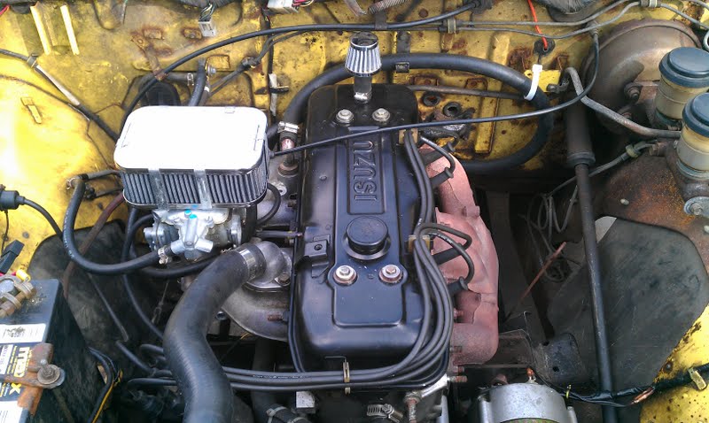

 Post subject: Re: Electric fan
PostPosted: Fri Dec 16, 2011 6:20 pm
Joined: Thu Mar 03, 2011 3:47 pm
Posts: 24
Location: Wildwood Fl
ive flushed it,replaced the thermostat 4 times, new water pump, my stock carb was running on one barrel so i replaced it with a weber, tuned it perfectly, timing is perfect, anything cooling wise has been replaced, im $2100 into the engine on a $200 truck, it wont overheat idling just with a load on it...... im stumped.
1977 LUV weber 32/36 dgv soon to be boosted
PostPosted: Fri Dec 16, 2011 9:32 pm
Posts: 219
Location: Bakersfield, Ca
Could have air in the system...,
Could be running lean....,
Could be too much retard on the timing...,
Could be lack of pressure in system...,
