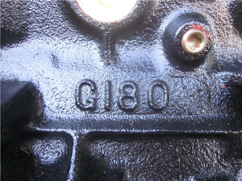

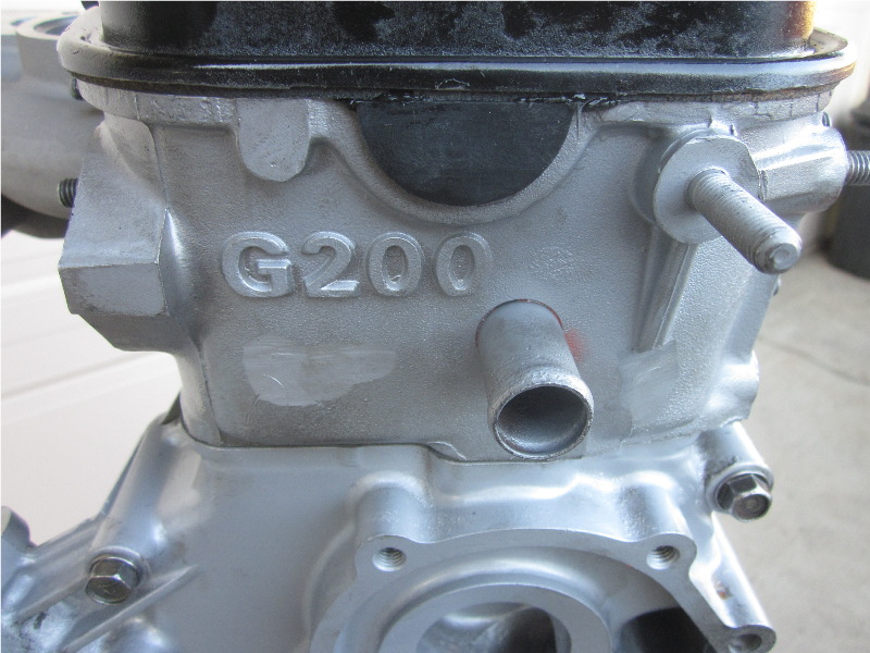

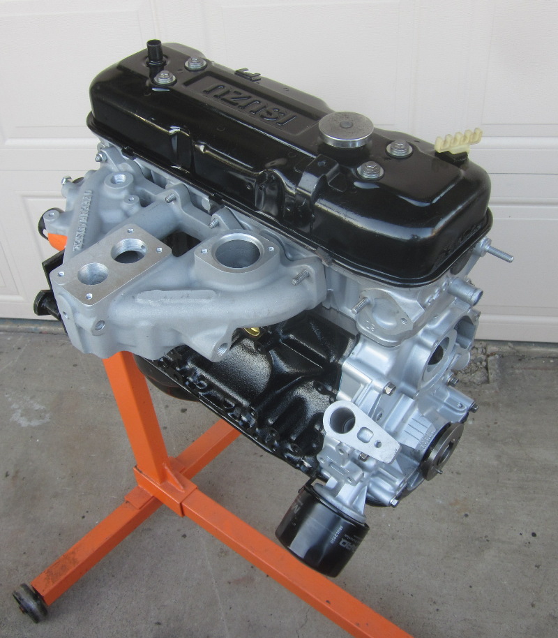

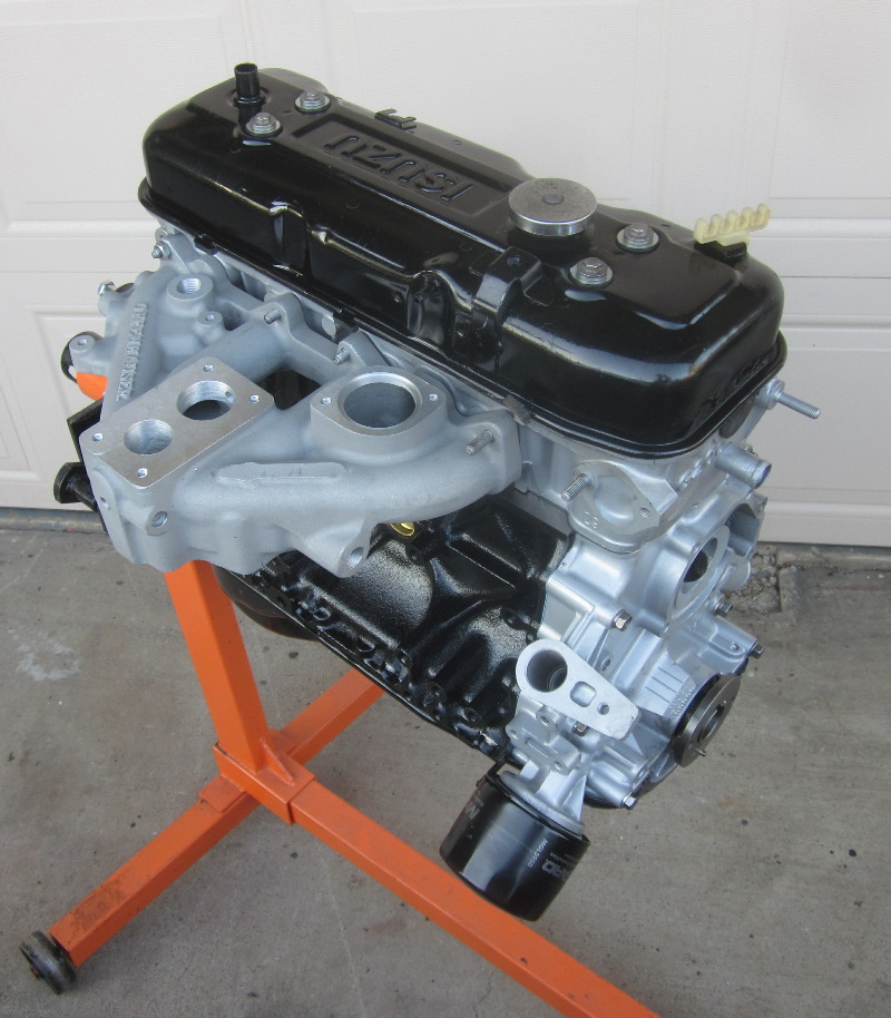

I was starting to bolt the accessories on and get it ready to install and noticed the head has "G200" cast into the front, is this typical of a stock 1980 4x4 Luv truck or was it swapped on?

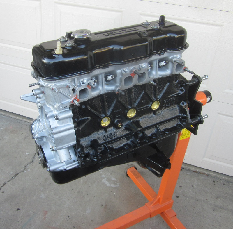

More pics

At some point in its life someone else has put that head on there... wont hurt anything. Compression wont be as high though. Will lose some power but seeing that offenhauser intake I am assuming you are going to run a weber as well so you will be happy with it. Get yourself a electronic distributor from a 83-87 pup with the 1.9l in it and put that on there as well and you will be happy with your engine. Looks great. Just did mine over the winter.

Yes, Dual Port Offy Intake, Weber, PaceSetter Header, and just ordered a good used Elec. distributor from a 1.9. The only internal mod other than a stock rebuild with all new parts is a mild RV cam. I'm also swapping to a 1986 Trooper 5 speed trans before I install it.
Couple more questions if you don't mind. What was the original color of these engines and were the heads painted or bare aluminum? Which starter and alternator should I buy for this engine? Any good resources for soft parts like molded heater hoses and other accessories?

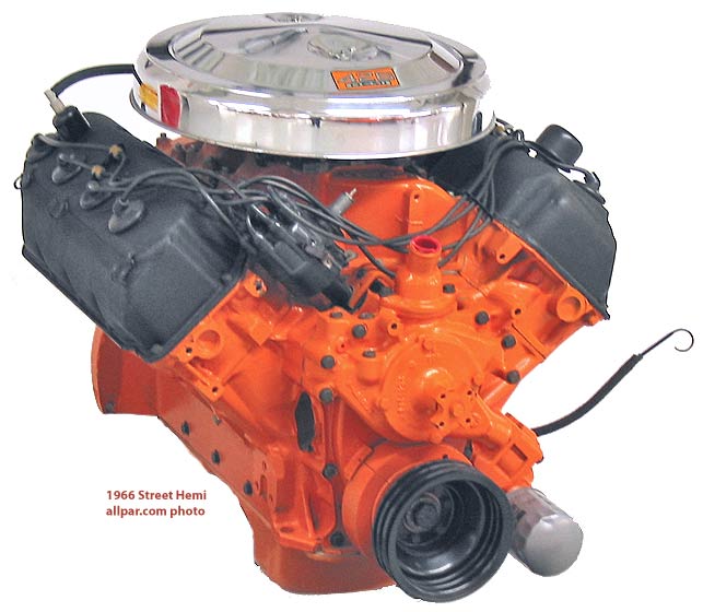

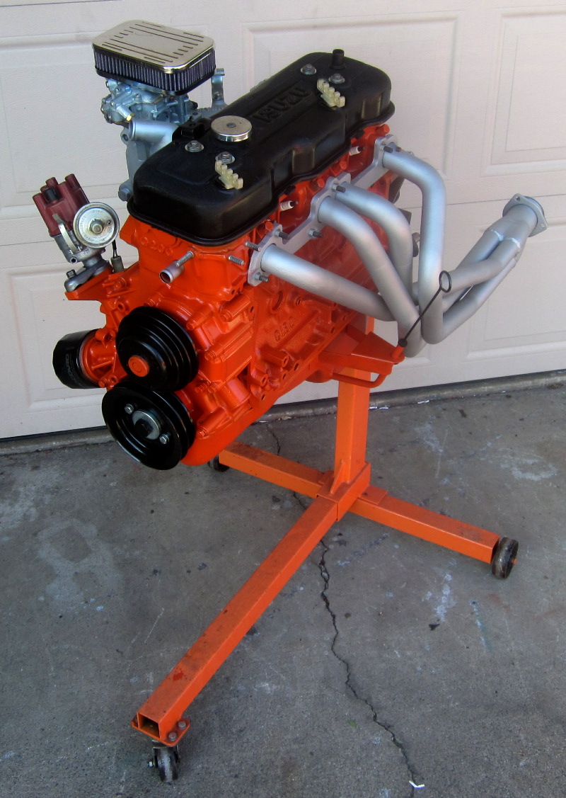

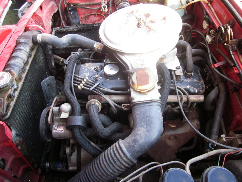

Well it's taken longer than I planned but I'm a few days from re-installing my engine, final combo is as follows: 1.8 block bored for new pistons, 200 head with mild port job, Pace Setter Header, Offenhauser dual intake, Weber carb and an RV cam. I also made a few changes in painting it. I am a died in the wool Mopar guy, and since this engine has a Hemi head design I went with the Chrysler 426 Hemi engine color scheme, Hemi Orange with a wrinkle black valve cover.
Wha La! Instant "Baby Hemi" :ebiggrin
Before and after pics. What do you guys think?
PostPosted: Sat May 14, 2011 7:55 pm
Joined: Tue Jan 19, 2010 6:55 pm
Posts: 337
Location: Webb City MO
looks really good

Well the G200 head swap bothered me due to the likely drop in compression/power so I took it and a spare 180 head I had laying around and the complete engine shown above back to my engine builder and had them make the swap. Now I'm back to a 180 head and back on track to mate it to the 5 speed Trooper trans and install mock up this weekened.
