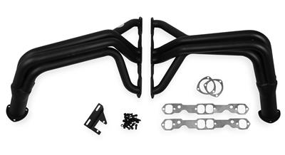

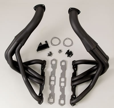

If I'm not mistaken fenderwell header should work. Here is a list of them-
http://www.summitracing.com/search/Depa ... Asc&page=1
I believe the Nova Super Comp fenderwell headers work on a LUV, and heard the S10 fenderwell also worked. Not sure have not done it. I plan on trying the Nova on my other LUV.
Hooker Headers 2102HKR - Hooker Super Competition Headers
Hooker Headers 2214HKR - Hooker Super Competition Headers
Hedman Hedders 65857 - Hedman Husler Hedders
