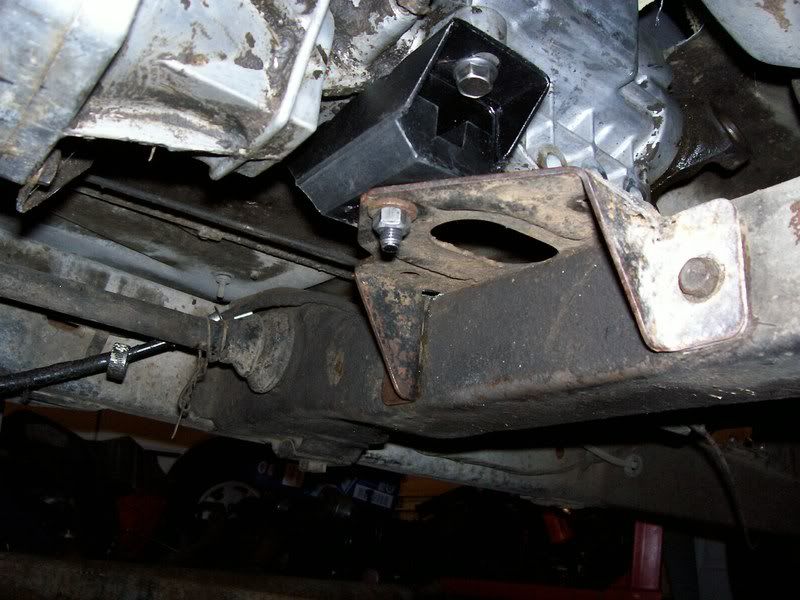

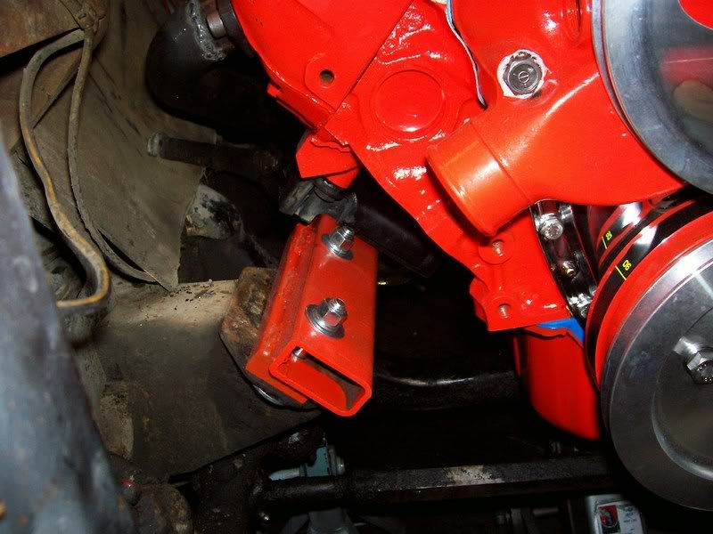

headers that fit the luv .
what motot mounts did u use and did u choose for the motor so sit that far foward

PostPosted: Wed Jan 27, 2010 8:20 pm
Posts: 773
Location: Caldwell ID
the moter monts are new for a 1969 chevy c10. the tranny mont is a 1980 camaro.
the moter just fit best thare. in a newer luv it would be ez to do . where the 1969 c10
moter monts are at would just about bolt right in .

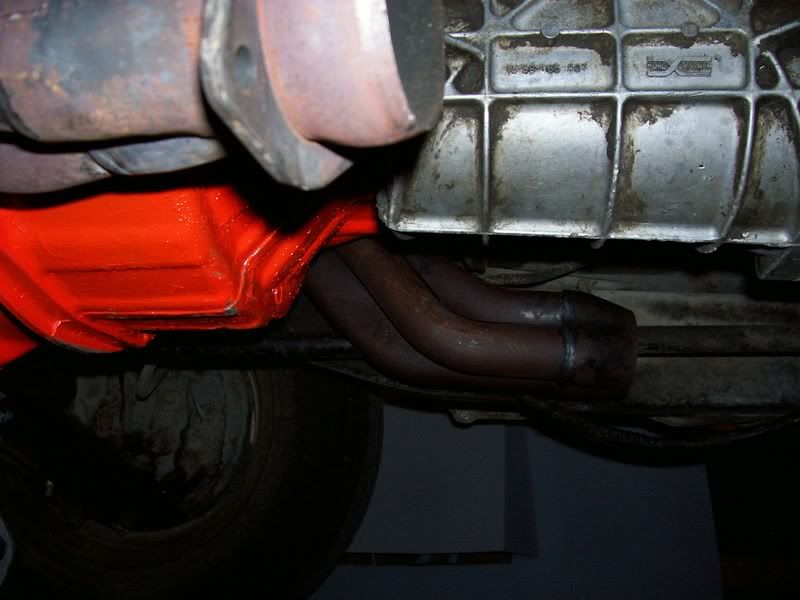

any additional information on these? brand, cost, where to get, etc.
and do you have an under-truck shot of how far down they hang past the frame ... if at all
PostPosted: Sat Jan 30, 2010 6:53 pm
Posts: 773
http://www.summitracing.com/parts/HED-6 ... refilter=1
the headers. fit with some modes to tham.
i like the way thay fit.

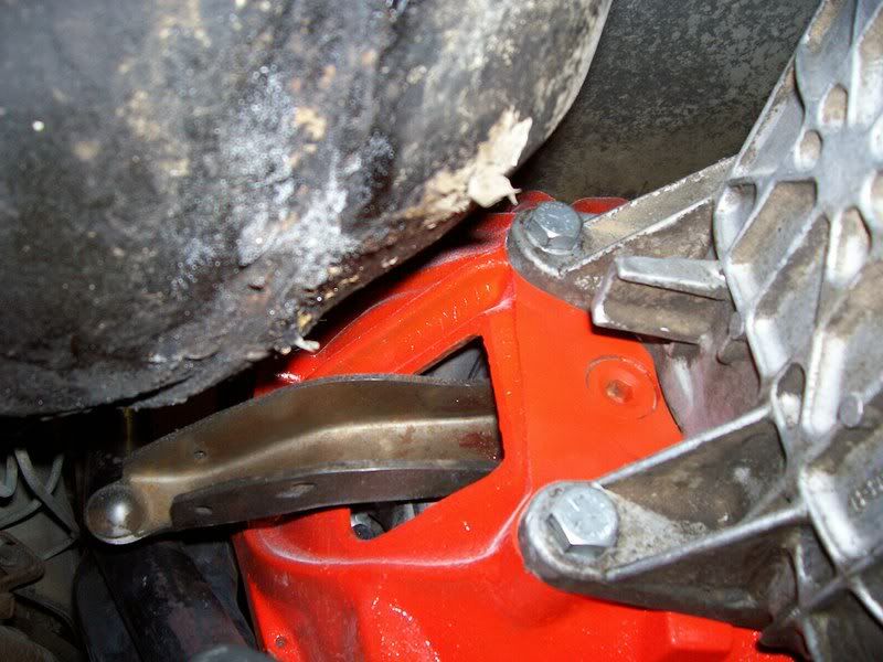

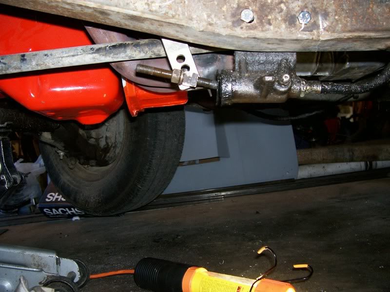

Posts: 453
what is that bolted to the frame in the 2nd picture?
Looks like an external slave cylinder for the clutch.

Posts: 773
yep. that is right. but the stock 1 was not doing the job. so its gone now.
