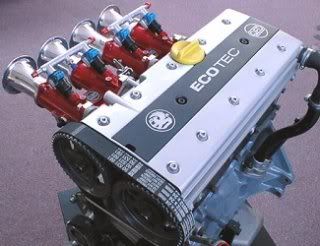

some pics you might like,Image Image the first one is a 2.2 with a keilser tremec 5 speed trans the other I dont know but its awsome and I want it :shocked!:
