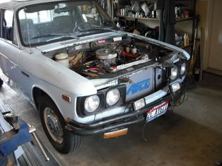

Since I can't figure out what size radiator vs engine, would a 19" tall by 22" wide aluminum (Speedway Motors) radiator keep a Chevy 4.3 V6 cool? I need to replace the radiator in my truck for the G200 and want to install one that will work with the eventual V6 conversion!! :D :D

i think myn is 19 by 22 its keeping my 4.3l v6 cool.

Yes, if the engine and trans are mounted properly. You should also be able to have AC with that radiator.

That size rad. keeps my 455 Buick motor kool in my truck.

shouldnt need much, I can keep a turbo V6 kool on the STOCK radiator.
